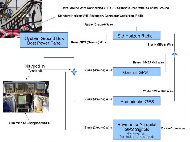

I assume you have the plug/ socket shown in the Autopilot manual and so I have made a wiring diagram for this to suit your boat.
The 12 volt power wiring to each item is also shown and I am suggesting you have a switch and fuse for each, though you may decide to combine some of these.
You can use a contact breaker in place of a fuse and often these incorporate an ON/OFF switch thus doing both jobs.
I have also shown a connector strip or block of the type used in domestic wiring and available very cheaply at hardware stores. Use the smallest size. Also the NMEA wiring is only light gauge wire.
To cut through the garbage, if a room full of people all talk at once then it is chaos. To overcome this the instruction is "Stand in Line and Speak in Turn". This is what NMEA 1083 does.
Apologies for a poor quality picture but this site instantly re-compresses my original diagrams to the point where they go fuzzy.
If you have doubts or queries please send a private mail through this site.

I don't believe that the purple out of the VHF going to the GPS is going to do anything. I don't use it and have the same setup with the GPS/VHF.
The VHF output is NEMA DSC and DSE sentences that are meant to be sent to a Standard Horizon Plotter as far as I can tell from the manual. If so I don't think they will do anything for the GPS you have and don't need to be conneced and possibly could create a problem, but I might be wrong. Try it either or both ways and see what happens.
Is your Eclipse the "+" model (more expensive) or the less expensive one? I have the "+" connected to just the output and ground of a Eagle Cuda 350 GPS depth finder and they work great with just those two wires hooked up.
Good luck,
Sum

Grounds in signal circuits
That ground keeps the noise out.
Not at all sure I'd connect it to the boat ground though. that could actually let noise in.
Does the manual say to connect it to the boat ground?

If not the boat ground then what ground do you use?
I could not get my SH to see the NMEA signals until I added a 2nd ground from the boats ground directly to the radio ground wire. Then everything worked like magic. There may be noise there, but everything needs to at some reference, especially for signals.
Just curious, are you talking about the NEMA common (-) or the 12 volt ground to the radio itself?

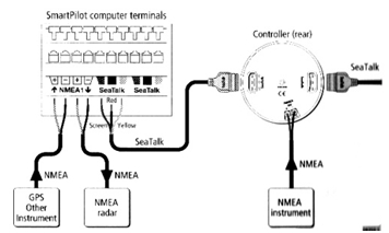

From my reading of the TP22 doc it should do everything that my WP30 does. That includes steering to waypoints. As old as NMEA 0183 is most pilot computers accept those standard "sentences" like BOD( Bearing Origin to Destination ) and WPL( Waypoint Location information ). Like everyone has been saying, just a matter of matching up two wires.
