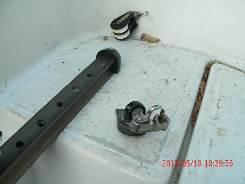

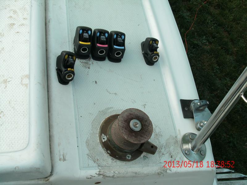

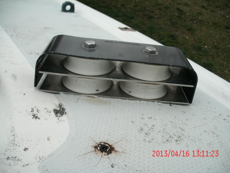

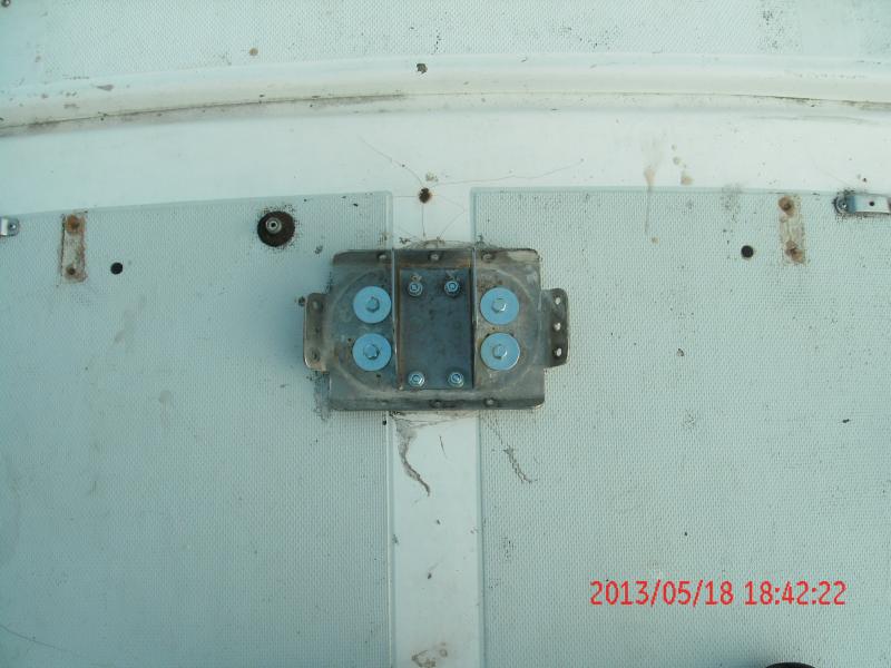

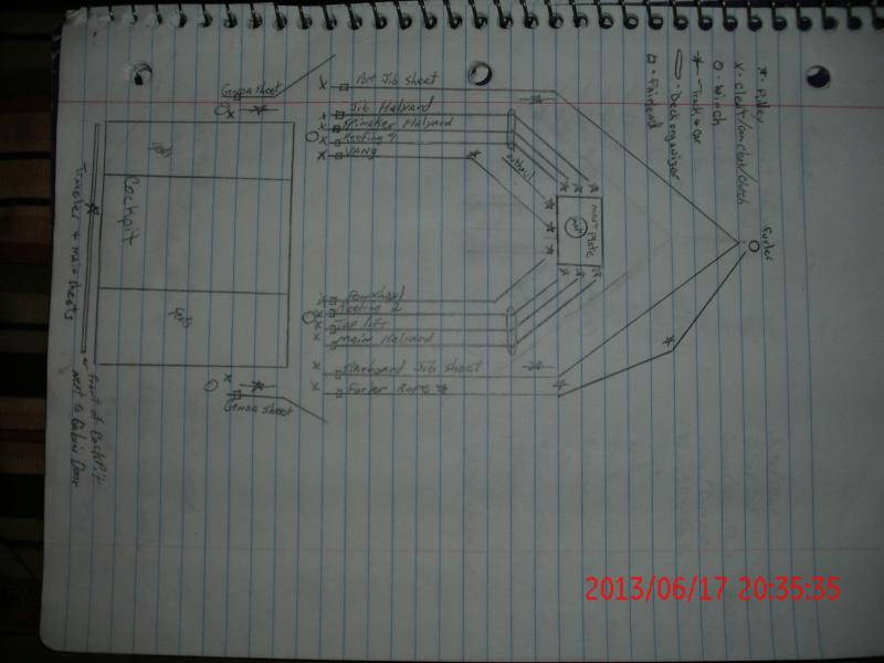

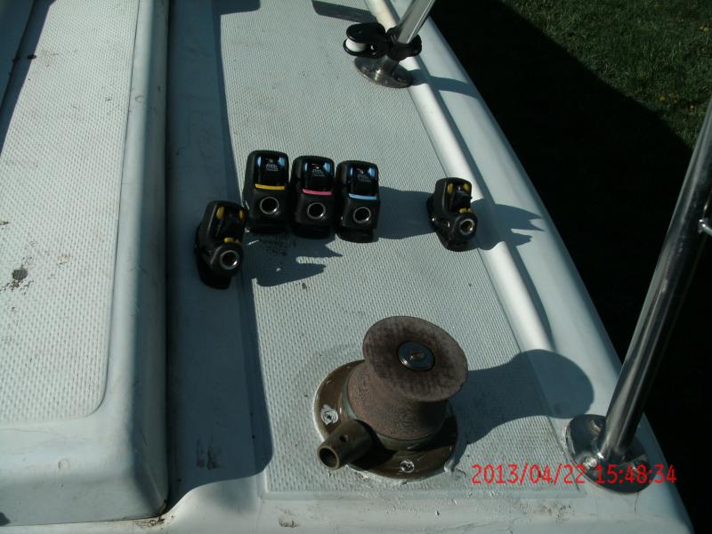

here is a drawing of how I set up my boat for solo sailing.... this should help you if you decide to set one up for solo sailing... also here are some pictures of the hardware I used to set it up with... the main thing you need is a way of turning the ropes at the base of the mast.... I used a block plate under my mast step... the block plate alloed me to attach up to 12 blocks as I needed them...
