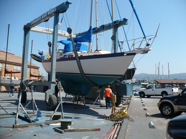

We just hauled our 1976 Irwin 37 CC sloop for what we thought was going to be a routine bottom job and shaft log replacement. When the yard hoisted the boat, the rear strap was under the aft end of the 3/4 keel. When they lifted it the fiberglass crushed in about an inch. After they set it off, they pointed out that the whole bottom two feet of the keel had become de-laminated. Once the crushed section was torn away it was clear that the keel was made out of cement. It looks like the cement was poured into the mold and then glassed in from above. There is a 1-2" gap between the top of the cement and the bottom of the fiberglass "hull" once the de-laminated sections were removed. It also looks like some repairs have been made to this keel in the past. Whatever the case we are looking at some expensive repair. Has anyone else been through this before?
