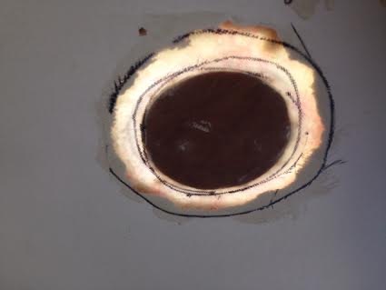

Here's a perfect example. I'm currently working to close up an old instrument hole in a customers boat. That bulkhead is 3/8 thick, tapered to 1/8 in center,filled with a 1/8 plug, then it has 32 oz of glass on the outside, and 24 ozs on the inside, plus the old bulkhead. See how much light shows through??
