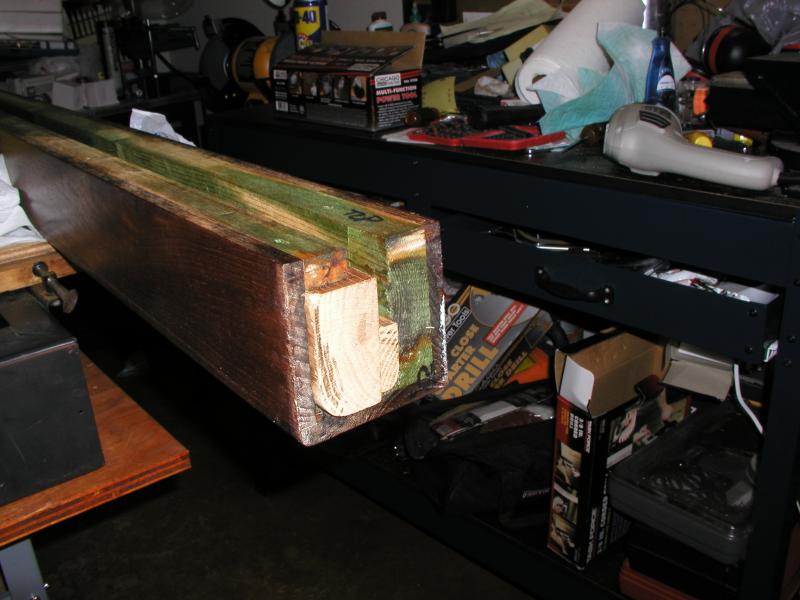

I had only a small top rotted spot on mine when I re-did the cross beam.. I routed out the bad stuff and made an oak block to fit.. then soaked the block in the green wood preservative .. soaked the innards of the teak-faced post as well then epoxied the block in place after a few days of drying in the sun.
As long as you are sure that the water has been stopped, a well fitted plug block epoxied in is a great fix.

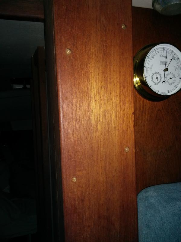

- Any issue to remove the teak fascia board? I presume just carefully remove the bungs and unscrew? Any glued parts to contend with?

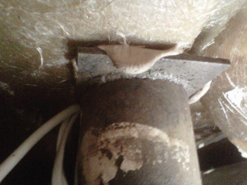

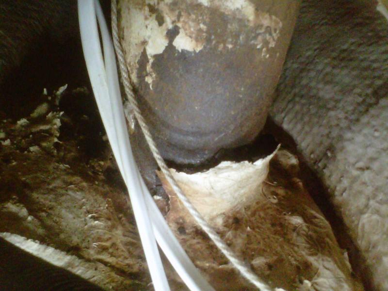

- Just in case you haven't, have you also checked the condition of your mild steel compression pipe in the bilge? I've posted a couple of pictures of mine.

- Nope, no glue. The screws are really soft so easy to strip, so be careful.

- yeah, checked it last year. Rusty, but I have off all the rust and it seems pretty solid still. I will seal it at some point.
