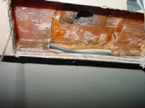

Inside the cross/member
We've opened up the cross member (above the compression post) on our Hunter 31. I've attached a photo. Hunter used an ordinary pine 2x4 and installed it laying flat. This is unlike the example shown by Allan Haddad in his H34. This may explain why it didn't handle the load from the compression post and the mast very well.

Mike O', I don't see the problem.
Mike: I don't agree with your sumation. There were probably 800-1000 of these boats mfg. I do not think that the placement of the wood made any difference here. Your boat was fine for 15 years. This entire problem is an issue with water infiltration. I am not sure that the wood in this area was much more than just a filler. Not all of the boats have ever seen this problem and I must assume that the wood was the same on all of them. Once the wood starts to decay (rot or dry rot) the filler collapses there is nothing to keep the fiber glass from caving in. My opinion on this problem is that the boats were not properly prepared by the factory/dealers. Granted they started to fail after 10 or so years but it really is/was a factory issue. If this wood was treated with epoxy or properly sealed these problems would have never shown their ugly faces. Have you put everything back together yet? I think that several of the owners have replaced the pine/fir wood with a piece of metal (Alum.). My boat did NOT have any detectable decay in the cross member. My damage was in the compression post and the bulkhead. We now have a stainless steel compress post with a teak wrap over it. Other than a small flange that presses against the cross member, you cannot see any difference. I guess we should all be happy that this was not a major failure.

No rot/Bad design
I had NO water decay of the wood inside the cross member or the compression post. The attached photo of the removed cross member pine shows 3 wires inside a void in the structure (aft facing side). This is where the fiberglass had bulged and cracked. The cause was poor design not water migration! The cross member doesn't properly support the center of the mast, the wood is not adequate to the task of handling the load, and the voids in the cross member were not properly filled at the factory.

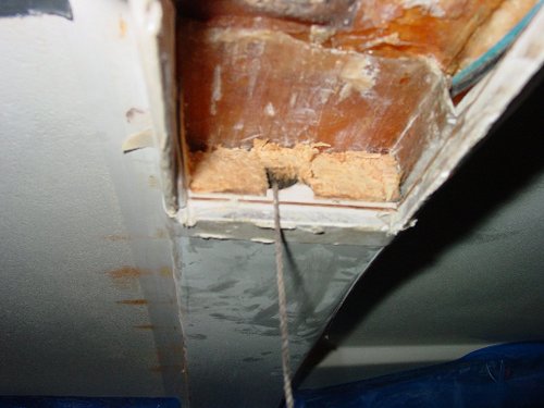

Crack salon view
Here's the view of the crack from the salon looking toward the bulkhead/compression post. Also, has anyone noticed that in the head area, the bulkhead is not tabbed into the side of the boat? It's just held in place by caulk! There are screws at the top and bottom only. I'll be adding two tabs inside the cabinet in the head when I re-install the bulkhead.

But Mike!
Mike: I have to stand by my previous comment. Bad design and a failure after 15 years? My H'31 and 'most' of the rest of the fleet of H'31
