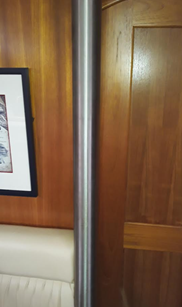

The one on my 2005 Hunter 46 (photo below) looks exactly the same diameter as my 2004 Hunter 386 of 3.58 inches (11.25 inch circumference / 3.14 = 3.58 inch). If you boat is the same circa year it might be the same.
