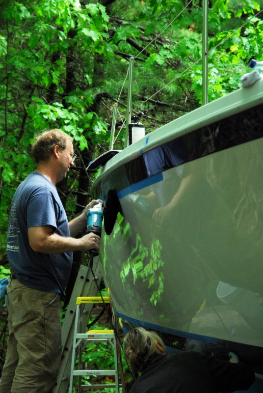

9:00 am:
9:30 am:

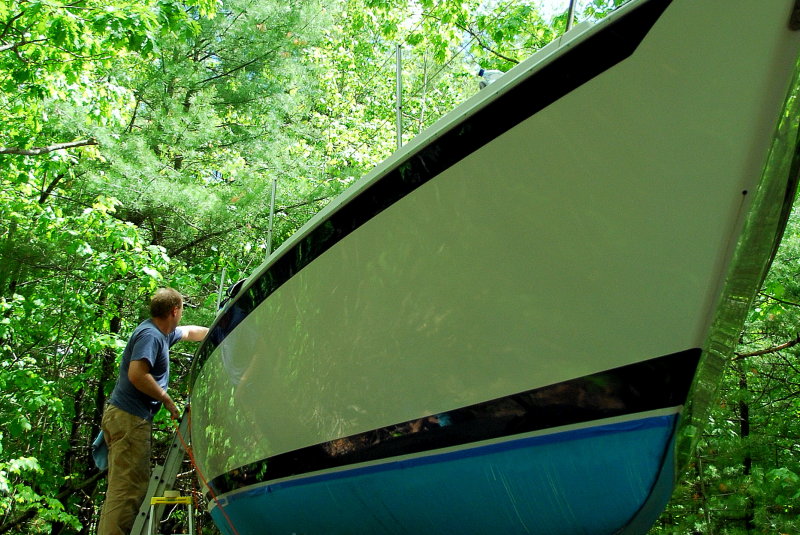

Working down the cove stripe Before/After:

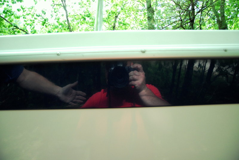

The toughest reflection is always straight on:

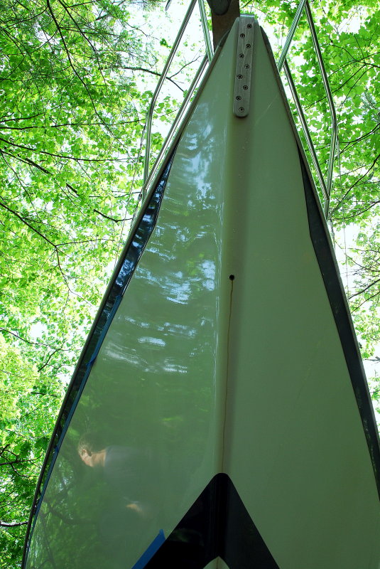

The detail in the reflection tells when it's shiny enough to start waxing:

She came out amazingly well for a 1987 that was fairly chalky! Actually she looks like she was recently painted..:)

I'd like to agree with Maine Sail that we did all the work but it is not true. Every time I think I have polishing perfected, I learn something new from him. One thing we did learn together that day was how great the Presta line of products are. I had recently purchased the Gelcoat compound and a white buffing pad. I polished my cockpit on Friday and then showed it to MS on Saturday. It did amazing things to a cove and boot stripe that we thought needed wet sanding. MS added some Cutting creme and a finishing pad to bring out that amazing shine. See 3rd photo above for before, then a small section to the right that was done with the Gelcoat compound and then the finished area after MS had done the final pass.

First Pass = Presta Gelcoat Compound with the Presta 9" black colored wool pad (it is recommended to use the white Presta wool pad with the Gelcoat Compound but Tim found the black to give higher finish shine. I think tim was using speeds below the #2 dial setting on the Makita buffer and he was buffing nearly dry but not all the way. One 32oz bottle did the entire Ericson 34.
Second Pass =
Presta Ultra Cutting Creme with a 3M Hook It Polishing grade wool pad #05713. This is a neat trick, using a polishing grade pad with a compound. It allows you to have a higher final shine when using a diminishing grit compound than you would using a compound grade pad with the Ultra Cutting Creme diminishing grit product. I was starting at speeds around 2 and finishing off at speeds of about 3.5 on the Makita buffer. I too was nearly buffing dry but leaving enough wet to not load the pad. (I still would not suggest "dry buffing" until you have some experience)
Final Pass = Collinite Fleet Paste Wax #885. Tim's wife applied this with a microfiber foam applicator and a spritz of water from a spray bottle sprayed directly to the hull. It was then wiped and polished up with microfiber rags.
