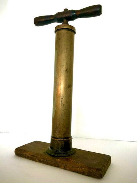

For your boat or auto tires to have compressed Air to inflate dingy, air mattress, tires, etc or blow out crap in small boat places try this one.
If you're looking to burn off those three extra helpings of turkey .............................
