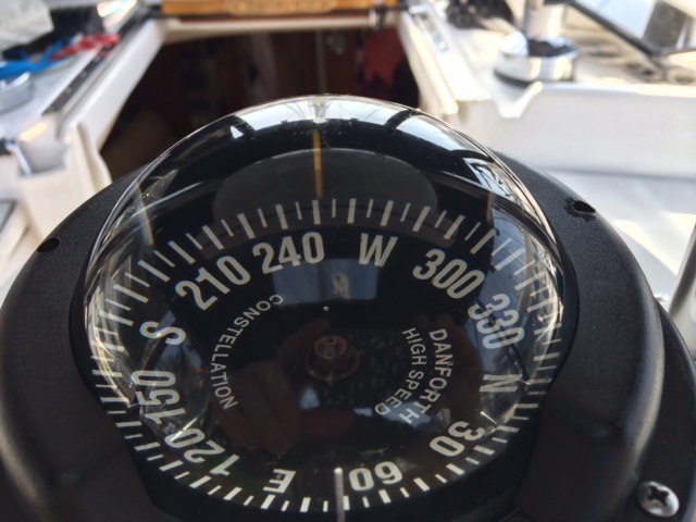

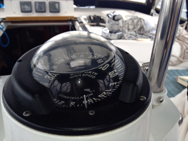

If it is a Danforth, I used Isopar compass oil from here
http://www.go2marine.com/product/21912F/compass-oil-low-viscosity.html
There is a bleed screw on the underside of the compass where you can bleed and fill. It was a very pleasing cheap fix.
Do it now! I always thought it was just a nuisance until trying to sail at night in 35 knot winds and I couldn't read my heading!!
