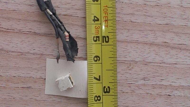

Hi,
Tiny light to compass worked briefly after I redid wiring when pedestal was apart then broke at connection to assembly. Nothing left to rewire.
Anyone know who makes these?
See photo, and thanks!
Lisa

Yes! I just emailed Ritchie compasses (my compass is a ritchie hf-79) asking about a local source for that very lighting (mine was MIA).
Customer service replied the next morning...
"Brewer Marine is in Hamilton and Ontario Compass is in Brampton and their contact information is attached.The SH-0029 ASY cost $13.50 each is the red 12volt light and the SH-0102 ASY is also $13.50 and is the green 12 volt light assembly for the HF-79."
Check your unit for make/model, maybe it'll be just as easy as that for you.
