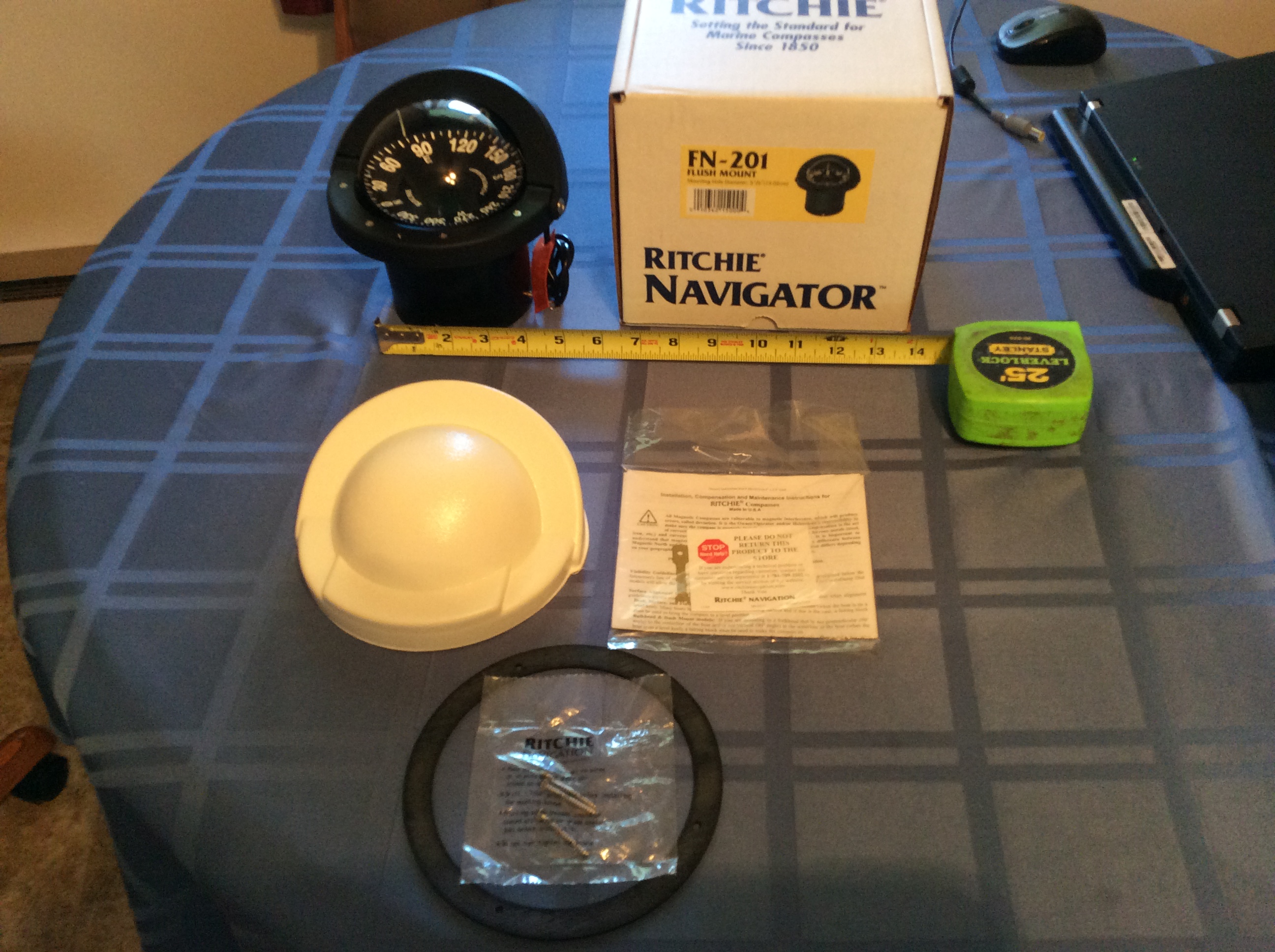

Nov 30, 2015
1,343
Yep, There was a gasket, three SS screws, and a small brass adjustment tool in the package. If the pedestal top is nice and planar I'll just use the gasket as suggested. All components shown below. The protective cover is a separate option, Ritchie Navigator SS-2000.
