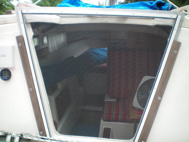

I finally trashed the broken,water damaged, wooden hatch screen and made one that the screen can be replaced in minutes. With my crew, that is often
I made a drop-in companionway screen frame using some thin plywood with bracing, and a plywood frame that drops into the open hatch opening and "mates" with the companionway screen. It took a couple tries to optimize the fit, but the result has proven mosquito-proof.Recess, I built the same unit as flynfol except that I extended the screen above the top edge of the frame, added velcro to the perimeter edges of the extension and to the companionway opening, so that it would be sealed with the main hatch open or closed.
