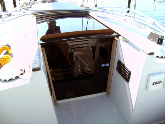

I'm going to make a hatch and roof like these myself. In Denmark it'll cost around 150 dollars in total.

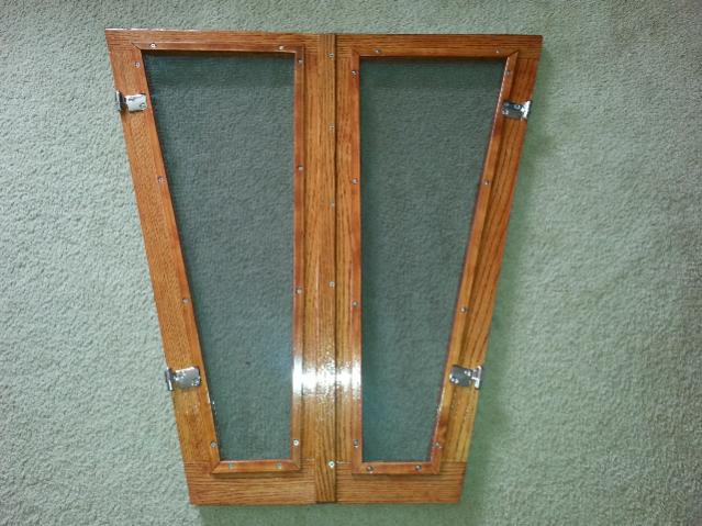

My husband made ours last summer. We had been wanting a set for a while, but he was reluctant since he didn't think his woodworking skills were up to snuff, but they turned out great! Only cost us about $60 too. They have slide in plexiglass windows and the screens can be easily replaced.
