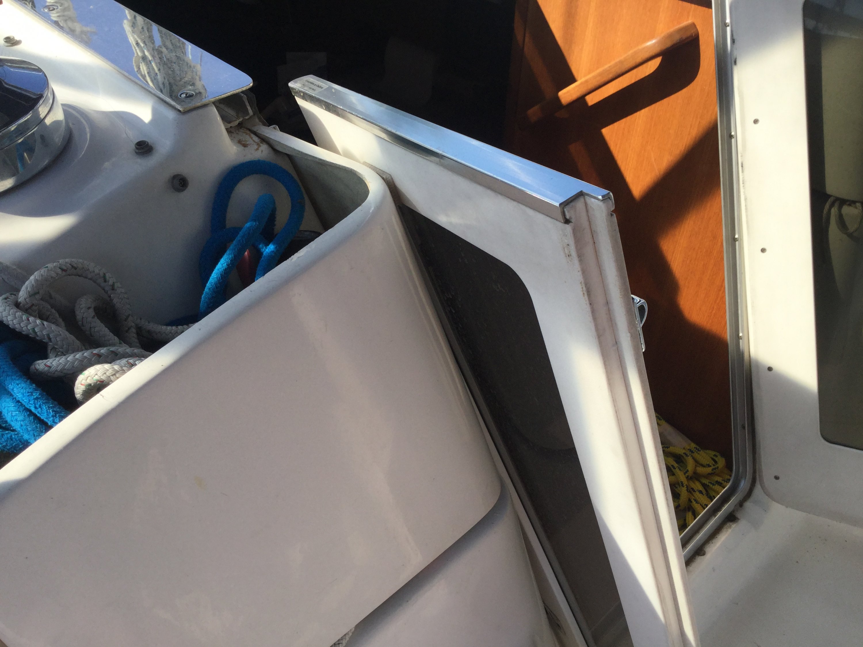

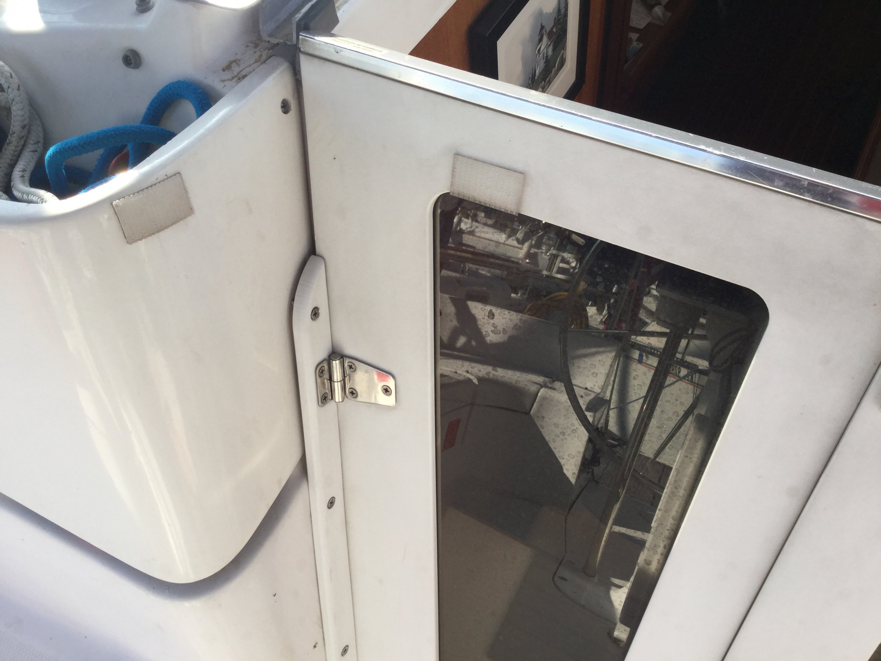

I have Zarcor and use 3M Dual lock SJ3561 and SJ3562 to secure the doors when open. This 3M product works great and you only need a small piece on each door and the sheet storage area on both sides
to keep them secure. We have lots of days and miles on ours and don't have any problems with them being a hazard in the cockpit. If the weather is hot or cold, we don't keep them open when cruising and we run our HVAC full time with genset.
