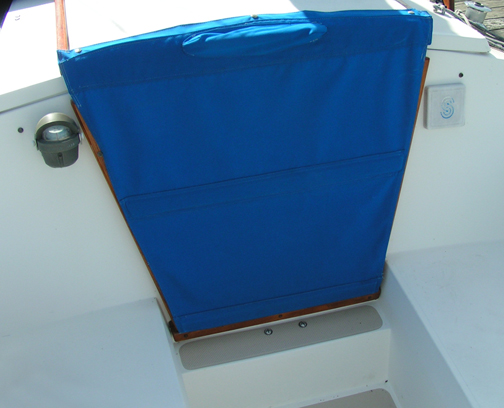

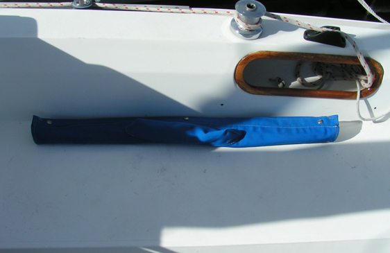

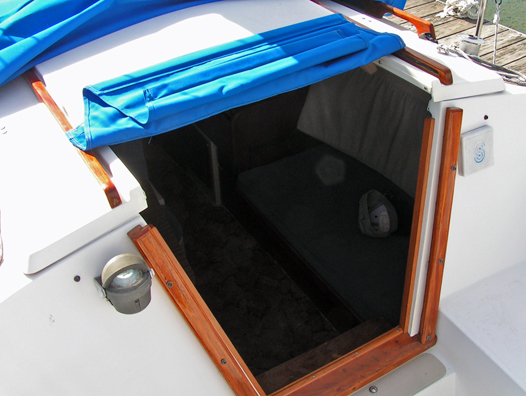

How about a canvas cover snapped to the top of the sliding hatch cover hanging down over the opening with batten boards to keep the cover tight sideways and against the side jambs and add weight to keep it hanging straight down.
Can be attached or removed in 45 seconds and rolls up to the size of an unfurled umbrella for storage. With batten boards, will work the same as crib boards in rough weather and no chance of damaging it if accidentally bumped into.
One yard of Sumbrella will make it at $18.00 a yard and $1.00 each for the snaps.
Works really great on a Catalina cause of the sloping back of the cabin.
Photos coming next week!
