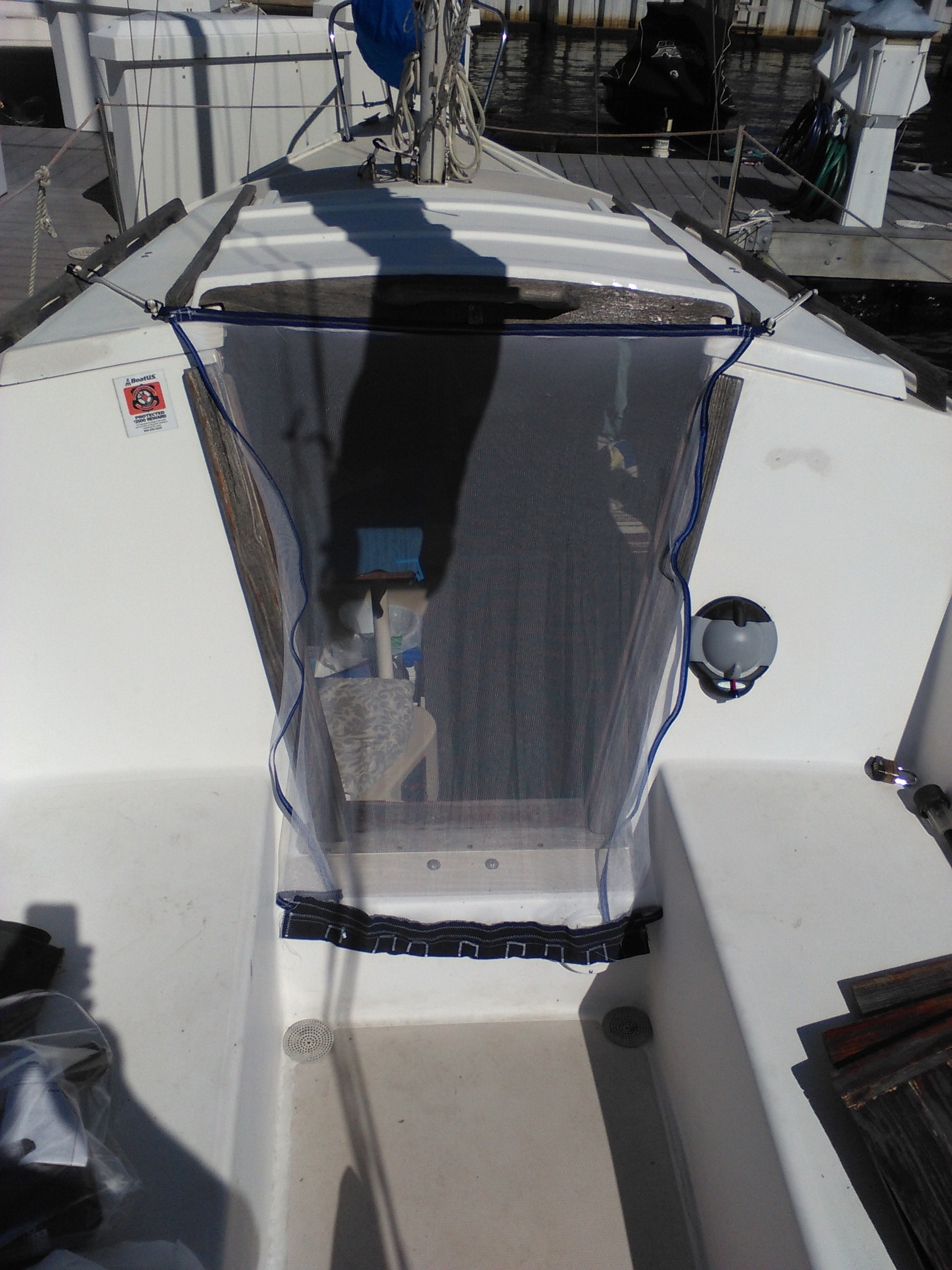

2 dollar piece of mosquito cloth from Joann fabric 2 bucks of edging, 98 cents of fish weights sewn in old
pillow case hem and two bungees for about 3 bucks. see pix

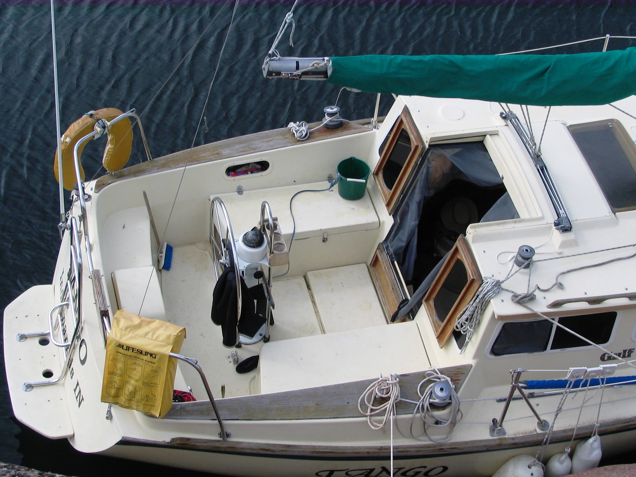

We tried weights at the bottom and chain sewn into the hem around the edges to hold the netting down. With the netting oversized, it worked ok. But it can still be blown and have gaps. Then we had one made for us (but it is a simple sewing job) that has velcro attaching it on all sides of the companionway and a zipper down the middle for going through it. In the North Channel of Lake Huron, the mosquitoes can be abundant and vicious. What I like about the current set up is that it is positively sealed in all ways when were are inside the boat after the sun sets. Entrance and exit for us is easy with the zipper (which is unzipped in the attached photo and during the day--you can see that the netting is out of the way).

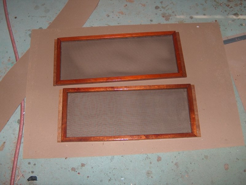

On our F-24 we have a large piece of netting with a sand tube attached to the top to hold it on top of the companionway and I use a couple of pieces of scrap reinforced hose which snaps nicely in the hatch slots on either side to seal it tightly.
Oct 10, 2011
619
Tartan 34C Toms River, New Jersey
Easier to stow in two parts. And since the drops are the same size, I can use a single drop and single screen on cooler nights. Either upper or lower
That is a good point. I have 3 drops, so I'll have to decide to make 3 or 2 making one larger (which I am leaning toward). Up here the nights are cooler except July and August. Sure wish that global warming would kick in.

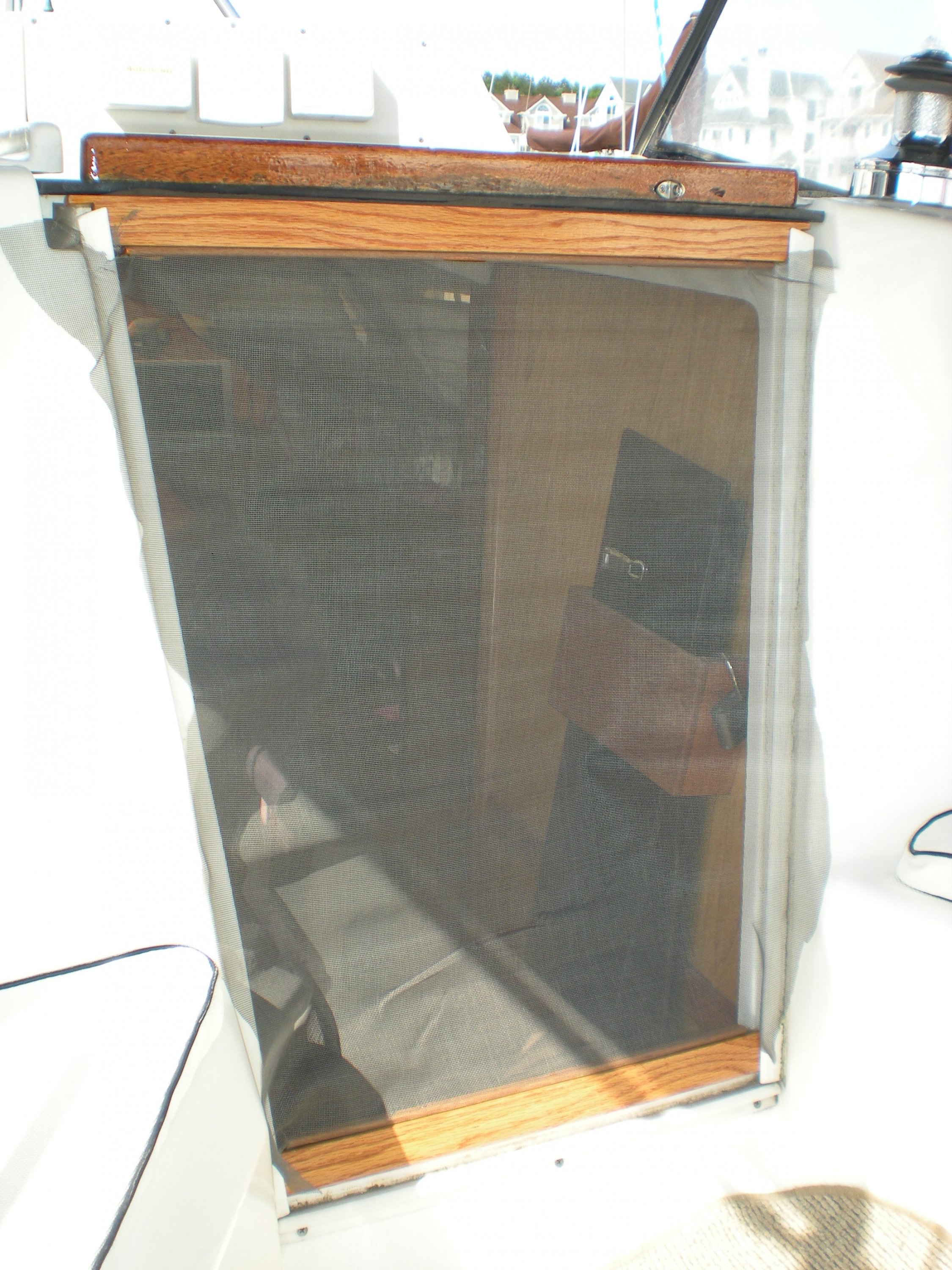

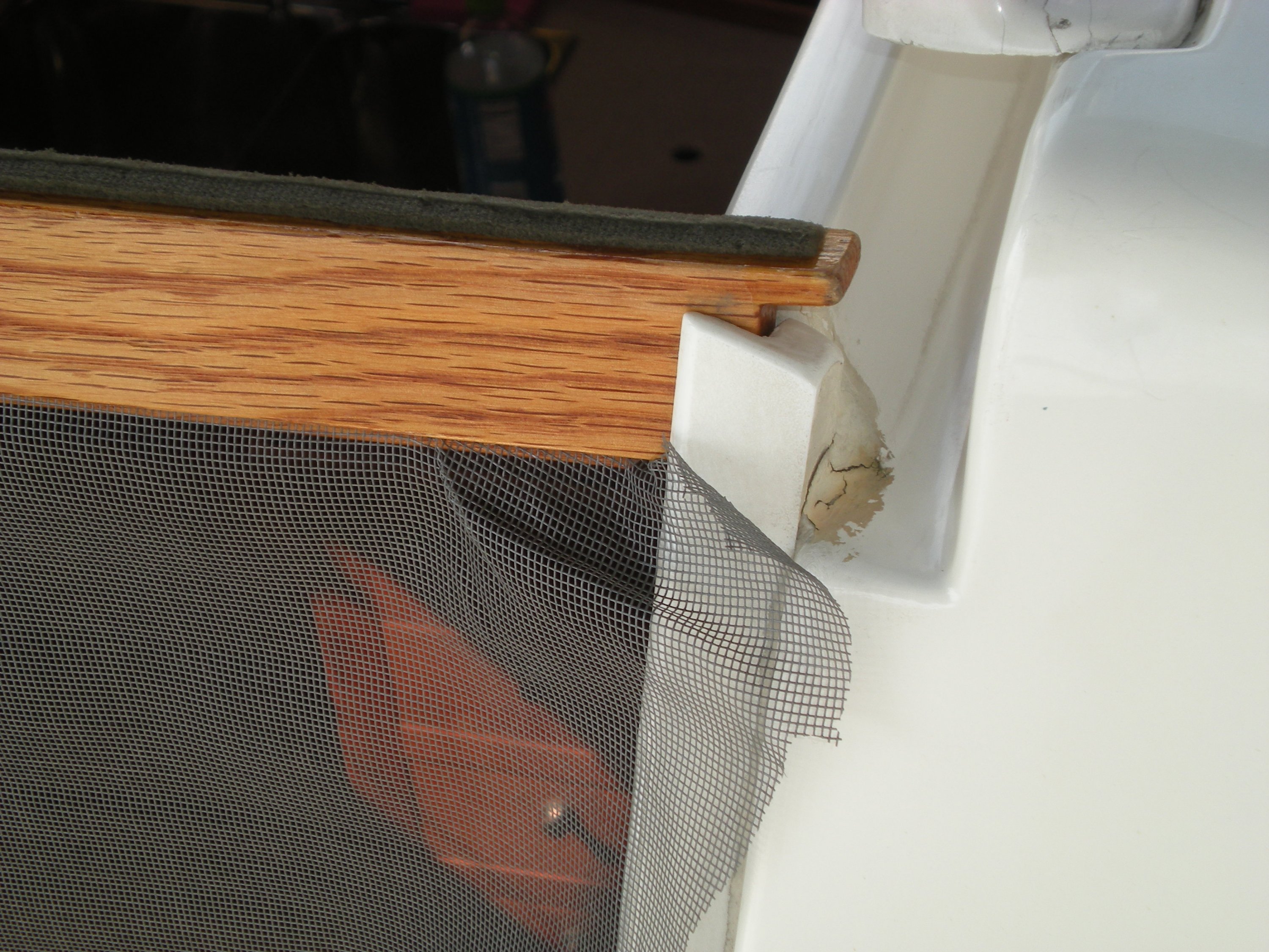

We have been using a novel screen design for our companionway. It consists of two 1 X 2 pieces of wood with a piece of screen in between. The top piece of wood is sized and notched to fit into and between the drop-board slots at the very top of the companionway and it fits tightly under the aft end of the companionway hatch when it is closed. The bottom piece of wood slips into the slots at the very bottom of the companionway. A piece of flexible screen is tacked between the two wooden supports and is cut wide enough to overlap the sides of the companionway. We usually stuff the extra screen into the side slots to hold it in place or you could use a strip of foam gasket material. A strip of foam gasket makes a good seal at the top of the screen and under the sliding companionway hatch. When not in use, the whole thing rolls up and is easy to store. Of course, you have to close the overhead companionway sliding hatch to seal the opening against bugs.
This is a good winter project since it takes some time and careful cutting to get the top piece to fit tightly across the top of the companionway. I have finished and varnished the wood to match the teak on the boat.
