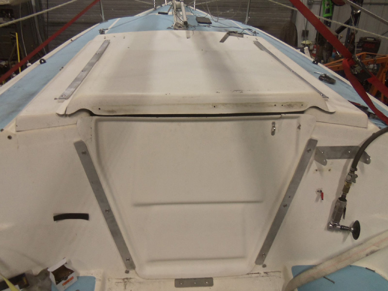

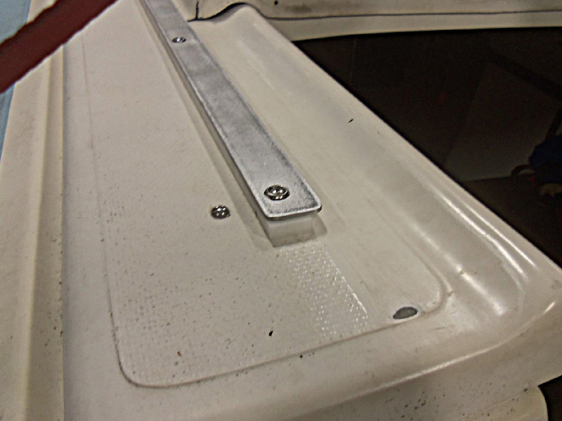

Thanks for your help/input. I'm leaning on a combination starboard type material and aluminum. see photos of someone else's modification.
