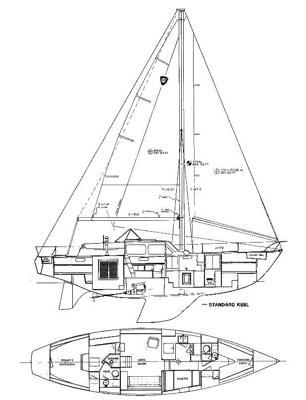

The Columbia 45 CC, is a relatively heavy and roomy boat for it's time. Its got a lot of free board and it's control surfaces (the combination of it's rudder and keel) probably require a more robust autopilot in offshore conditions.
