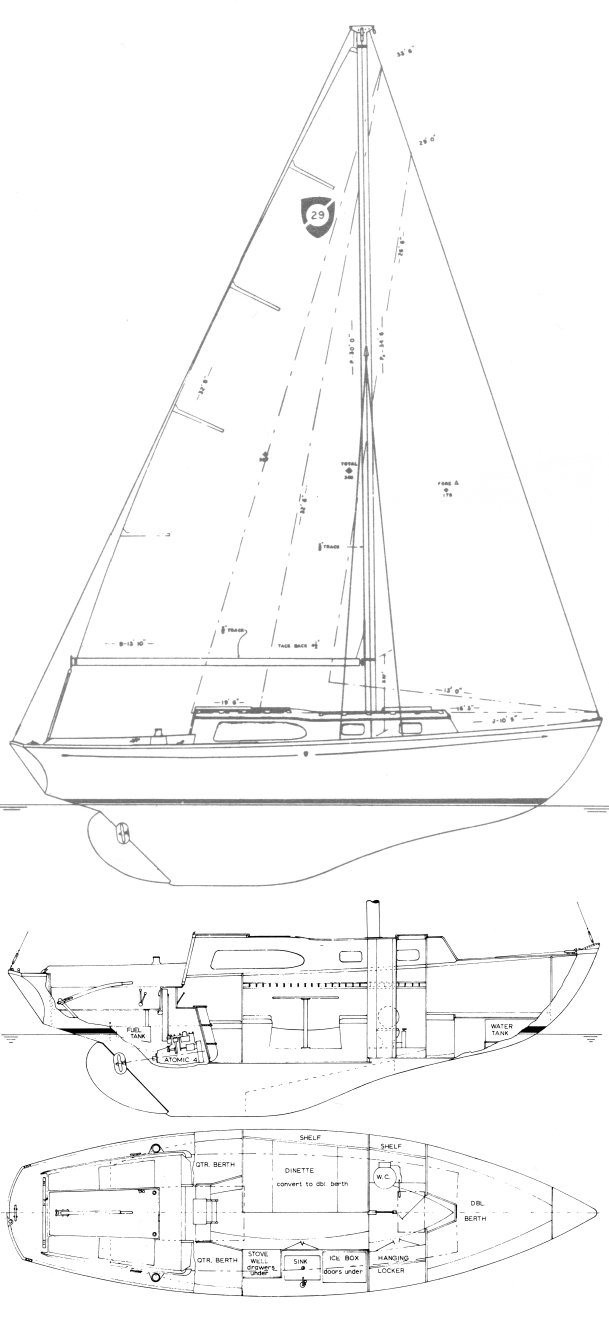

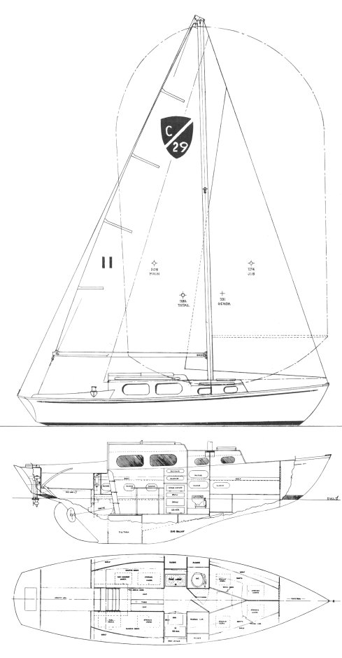

Just look at the long keel on both of the designs.
This is the original 29
This is the 29 MKII
