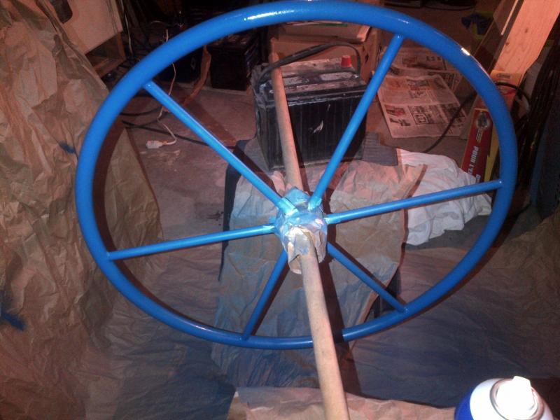

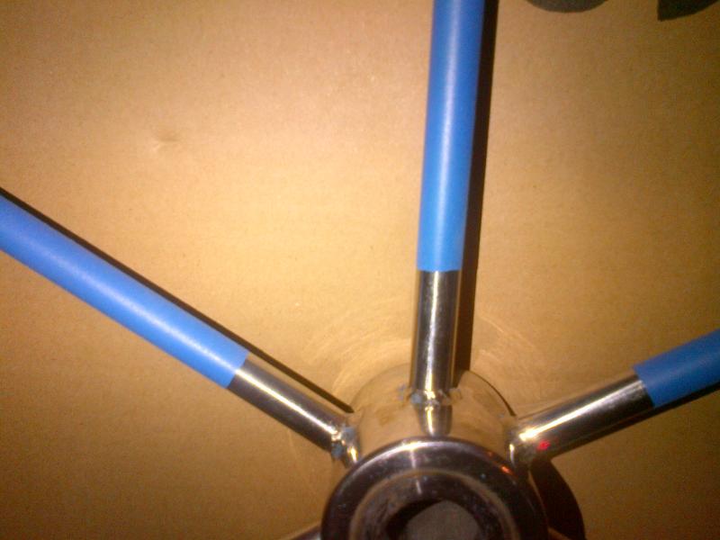

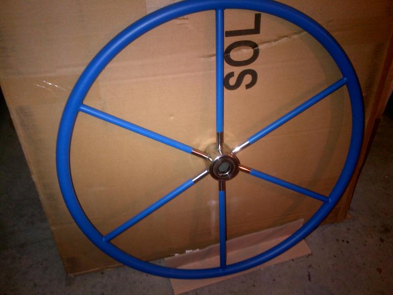

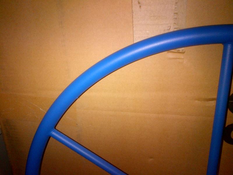

I decided to try this Plasti Dip product that many car enthusiasts use. It is a rubbery product that comes in a spray can which you apply just like spray paint. Usually this is applied to tools as a rubbery grip on handles. Here are a couple of pics from application to finished product. The key is light coats and allowing proper dry time between coats. I used one full can at a coat of $20 and there are numerous colors to choose from.
We'll see if it works. So far I like the feel. If I don't like it, I'll just peel it off. I would say it is about 1/16" thick.
