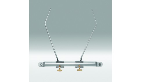

Mine are the ones for the gimbaled Origo Stove. They work well unless you are pounding upwind in seas, then they let stuff slosh. Using a teakettle and sealed pressure cooker solves that problem.
Origo Pot Holder
