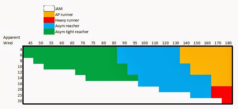

And yes downwind sails are targets. We use something like this.
