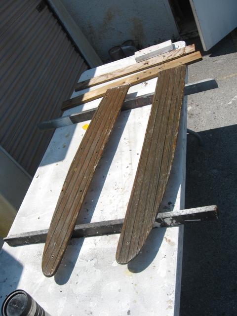

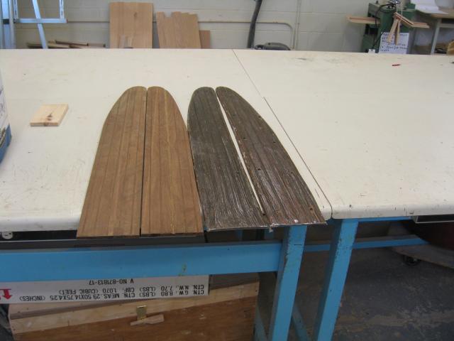

The teak steps (boards) on the edges of the cockpit were not the best looking and needed to be refinished.

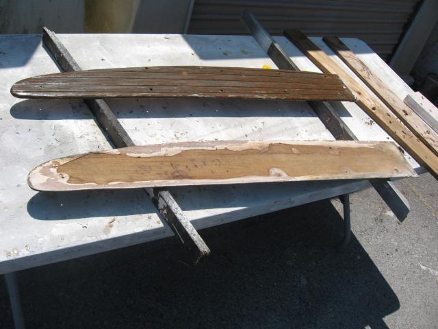

I decided to take them out and strip the many layers of varnish plus Cetol plus whatever had been layered on them over the years.
Once off, I realized it would be just easier to make new ones.

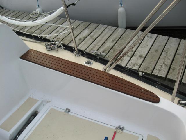

I had a plank of Ipe that I shaped taking the old boards as templates. Split (very hard wood with pollen like dust) and planed, and grooved using the blade on the table saw. I attempted to machine the lines with a round bit but that didn't go too well. This wood is so hard that even with small passes the brand new router bit would jump so I decided to just keep the square blade groove instead of the U.
I gave the back side a couple of coats of clear epoxy, bedded the boards in silicone screwed them down. Actually before that, I repainted the whole cockpit after filling the old screw hole, fixing the cracks and filling in where I took the old "city" water intake fitting as I don't foresee using it.
The only thing I used on these new boards is "teak" oil which is probably lemon oil with UV filter.
They're a little dark but it sure looks better than the old ones.

Nice looking.. I am a fan of IPE much less dollars than teak.. and a fine tough and pretty wood.. but it is a bugger to work and I think the dust is a real irritant to nose .. I wear a mask now when I work it.
Good Work !

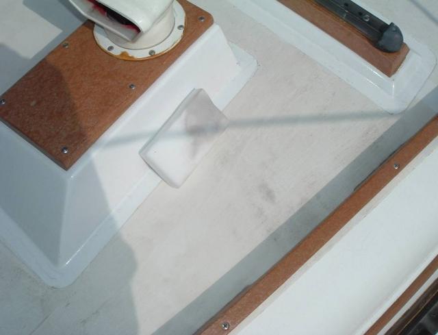

Making me feel bad, you finishing projects that I have been planning for ten years. My winch pads look like your old steps. The three years in the south really did a number on my teak. And everything is painted except my cockpit because I want those pads off first. But they are under a big winch and a big cleat with little access to the nuts.
When I do the pads it will be with PlasTeak like my forward traveler, dorade lids, and ladder steps. No more varnishing(except hand rails). In picture are PlasTeak handrails but I made them myself and didn't like them. Originals in basement with several coats of varnish after Florida ate them.

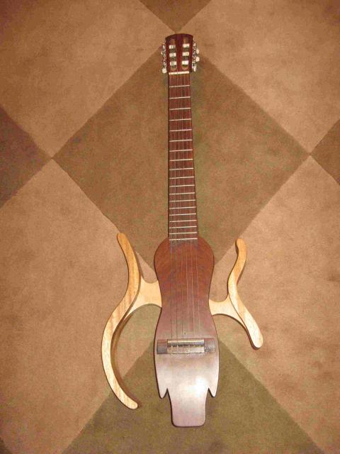

Very nice outcome. Fine craftsmanship. I also like IPE and have sometimes suggested it on various posts as an alternative to teak. Also because it is so hard, that the wood makes great backing "plates" for things like winches and anchor roller/windlass fittings. Might not be the easiest wood to work with, but shaping and drilling holes is a lot more convenient than in aluminum or SS plating. And IPE has applications for finer projects ... see my electric guitar picture ... the body is left-over IPE from a back yard deck project!

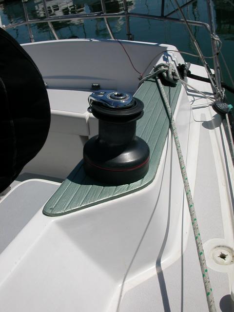

The attached photo shows my port-side winch pad 5 years on. Paint is Rustoleum's Hammered finish. This is the second color, the first being gold. When the paint gets a bit crusty and flaked, five minutes with some rough sandpaper along the grain and its ready for a new coat. No need to sand down to bare wood. I've grown to like the look, so replacing with new teak or IPE isn't likely.
Silver is also a Hammered color. Or mixing some combination of gold+silver+copper might give close to the plas-teak color and might match your tan (I think) non-skid color. Think about how it might look on your boat as an alternative until you replace the existing with plas-teak. Hey if get get used to the look, you may never get around to your decade delayed project!

Ed Over the years, mostly for home projects, I've amassed a collection of various Hammered colors. The color is green, softened quite a bit to a more "mist green" by mixing with silver. However, with my first try, I found the combination was improved (to my eye anyway) with the addition of just a touch of gold. On my computer screen the color looks quite close to the appearance on my boat.
"Doing this" to teak (painting over the natural color) is contrary to the normal thing that comes to mind around boats. I just bring it up on occasion in case it might work for somebody else.

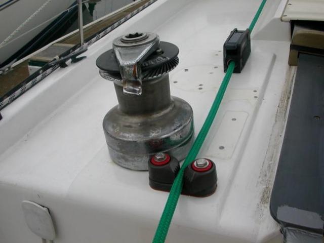

Well I have been wondering what to do with my teak pads. They are worn out. What do you use the cleats for on the winch pads? I have self tailing winches and the jib sheet stays locked in the winch. We are at a floating dock and if you attach a dock line to those cleats they will either eat through the lines, or the leather that I sewed on will eat whats left of the teak pad. Not to mention those cleats hurt if you try and sit there; which is where I like to sit. Rardi, I posted video of the more protected marina that I went to. I couldn't make it out to sail if I wanted to. The weather people were wrong again. We did however go out Tuesday and it was wonderful. Felt like San Diego,wrm sun cool brieze and dry air.
Oct 29, 2010
136
Hunter 36 Pensacola
I have been wanting to change mine too. They are worn. I have tried attaching dock lines to those cleats but they wear down the wood. I don't like the cleats' placement. That is where I like to sit and the cleat gets in the way. I have self tailing winches so I am wondering if the cleats aren't needed. There are some cleats on the outside of the cockpit just aft of the cleats. What are they used for?
Jun 2, 2004
5,802
Sounds like our boats are alike back on the coamings. Rardi's pictures of the pads look like my 37C. The most aft cleats on my boat are for dock lines. The cleats on the top behind the winches are for the jib sheets. The winch should not be the only tie-off for the jib except in light conditions. I always secure the sheet to the cleat so as not to get lazy and forget. My boat also has cleats on the sides of the coaming slightly ahead of the winches. They are at an angle and the sheets are led through the center of the cleat. With a stopper knot in the sheet this prevents loss of the sheet.
