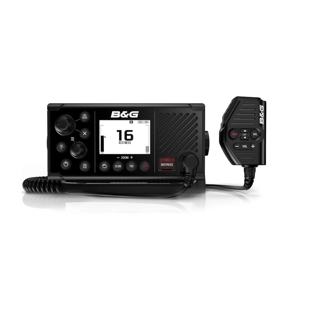

I changed to a wireless mic, love it. You can be anywhere on the boat and use it. I have a B&G V60 with 2 wireless mics which can also be used as an intercom. The one drawback to wireless is battery life. I get about 8 hours on a charge which is fine for day sails, however we were planning multi-way offshore sails so we have 2 mics and rotate them. If you mount the charging cradle at the helm then you can get away with one mic.

I use the B&G version, with a wireless remote at the helm.
Radio provides AIS info to My Chart plotter, and CP provides GPS coordinates to the radio (via N2K). And handheld remote at the helm communicates with the base unit and uses the masthead antenna… so better range than a hand-held portable VHF.
My older version is the V50, but I believe they have a newer version…V60.
