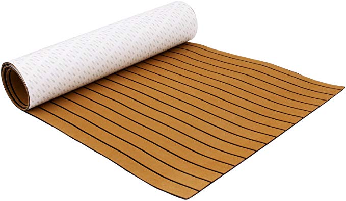

you can get this off of amazon. this stuff is water proof ,spill proof and is cheap ,however don't know how good adhesive is teak and holly sole is only a veneer over plywood and would not be suitable for outdoor usage
