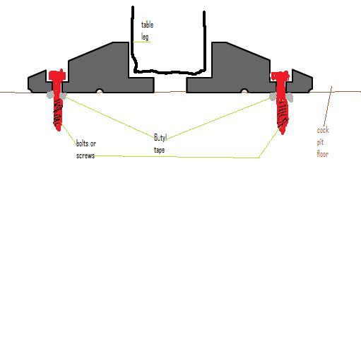

Here is an idea.
Note the use of butyl tape. Here is a link on how to use it. http://www.pbase.com/mainecruising/butyl_tape

Thanks for your answer, in any way i'll use sealing compound, but i'll take KENT for it. I would like to know if any of you have an idea about how is the structure of cockpit floor designd. Is there a iron or aluminium plate laminated in it or not (like on places that needs special force).
