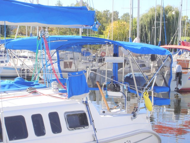

Cockpit Sun Shade for Back of Bimini
May 17, 2010
81
Hunter 270 Ottawa
We used 2 inch wide strips of Sunbrella to frame "pet screen" material from Home Depot, to create a sun panel for the back of our Hunter. It is made of 2 panels that zipper together & is attached to the bimini with stainless fasteners for quick set up. The screen adds a fair amount of sun protection while providing good visibility & air flow. We might add removeable solid Sunbrella panels for when the sun is shining directly into the cockpit. We are going to add side panels next season.
