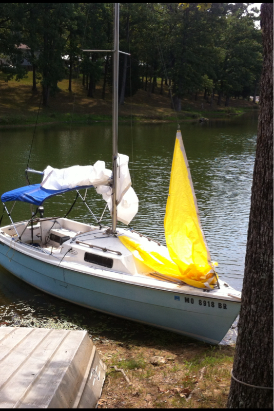

Well I had a run a bout and since the floor was rotting out,I told my wife that,I took our Bimini off the speed boat and put it on my sailboat now it gets in the way but its something I can live with.

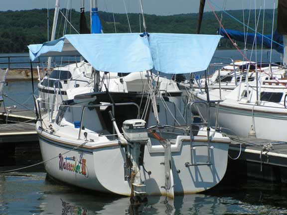

I created a design the full length of the boom and supported with hardware store expandable long paint roller handles. I made like batten pockets in the outside edges to expand the handles into to hold them in place. The front end is held centered over the boom by attaching to the main stays and a strap running down to a stanchion base to keep from lifting in the air like David in Sandusky’s does.
The rear end is bunged to the backstay to keep it stretched tight and an extra extension beyond the end of the boom comes down and attaches to the stern pulpit to keep it from lifting in the wind.

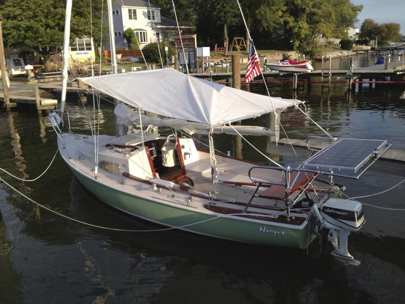

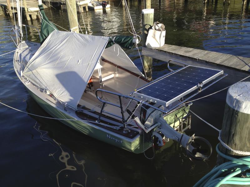

I made up a shade from an old mainsail, that when turned the other direction works as a boom tent. Used 2 small dia. extendable aliuminum poles.
Worked so well, I'm getting a "nice" version, [without the "belly"] made at the local shop.
The new version will have a 2' panel that zips onto the aft end that when used as a tent the coverage will extend to the end of the boom.
