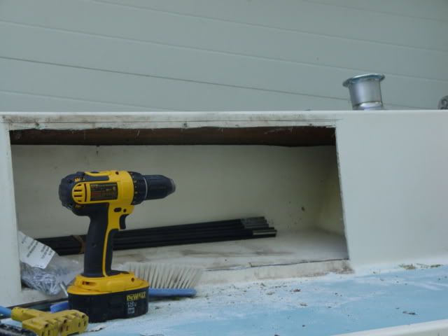

This is the port locker after the hole has been re sized.

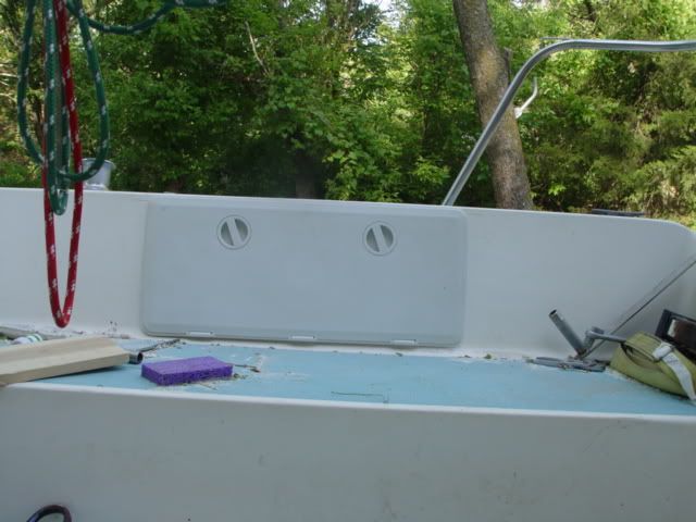

Here is the Starboard after installation.

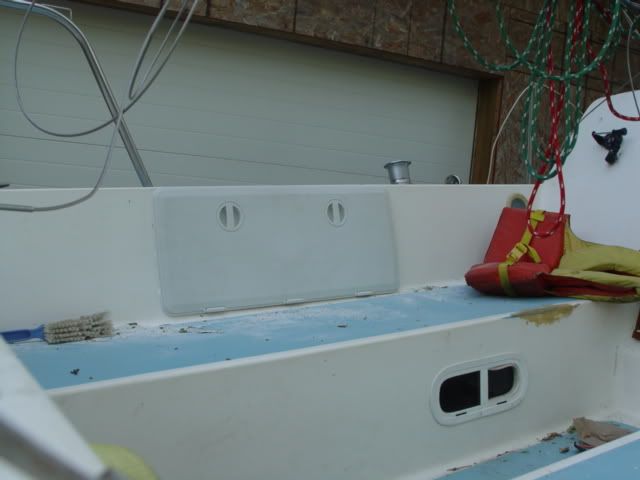

Here is the Port installed.

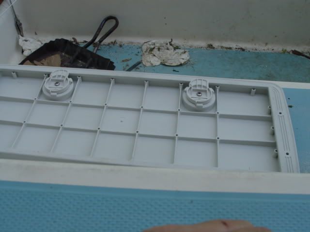

Here is what the under side of the hatch cover looks like.
