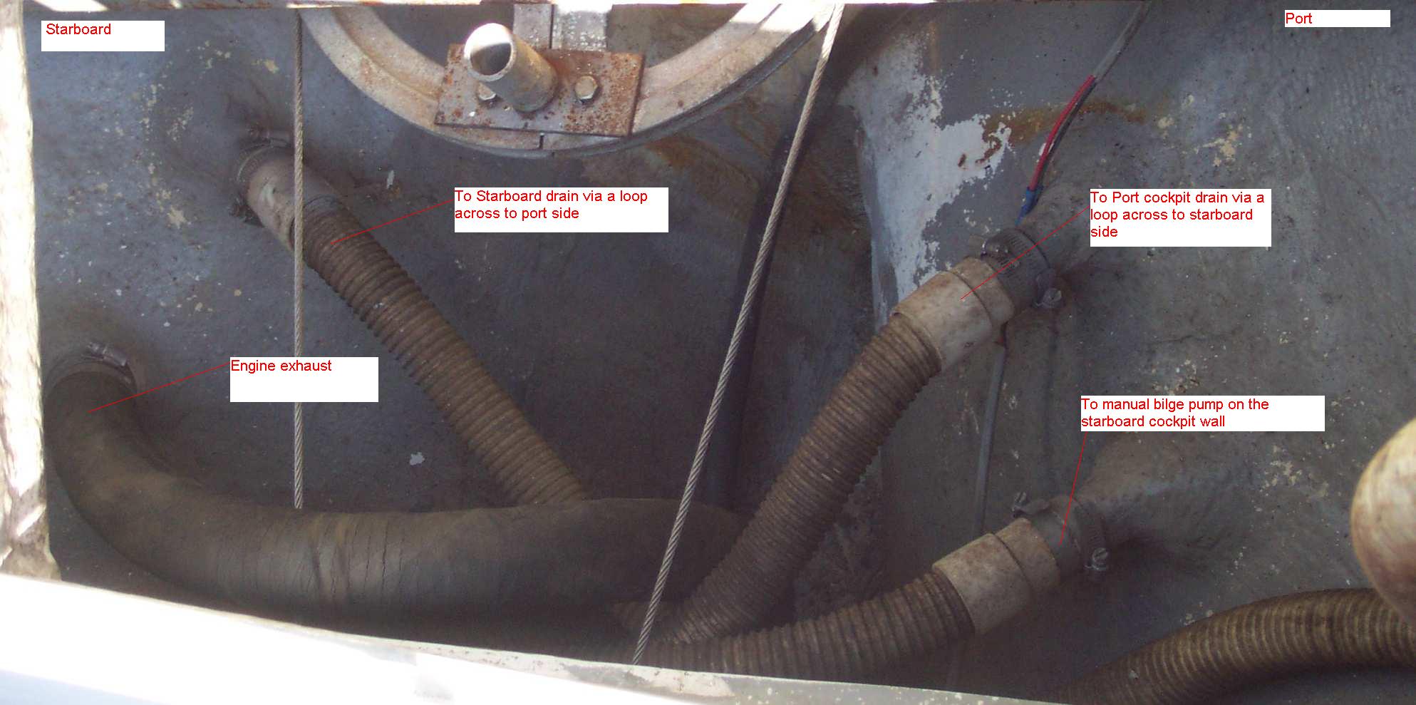

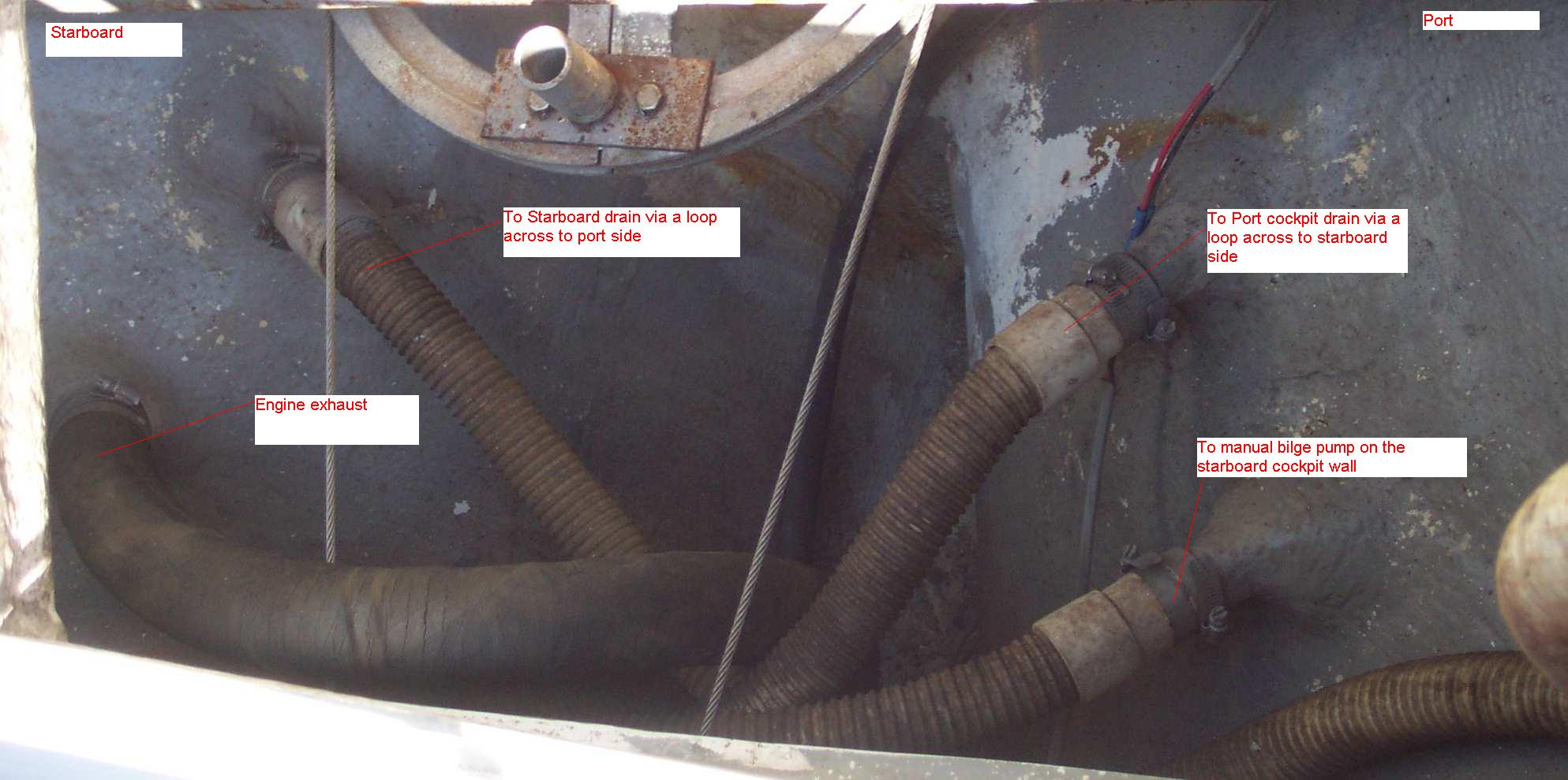

The original HC37 installation had the cockpit floor drains crossing to the other side before exit through the hull on the same side as the drain hole. The first picture shows the original installation in my boat.
This was done because otherwise, if you are sailing heeled and fast, water spits up into the cockpit through the drain. I found that out after installing new drain hoses without the cross over.
My reasoning for eliminating the cross over was that it would promote better draining. I am probably never going to change back because the "spitting up" has never been anything but a minor issue and the drains definitely work better. There is also much less spaghetti down there.

JohnB, what year is your boat? Interested because my 1979 exhaust and manual bilge are on port.
1,090
My hose arrangement is the same as John's - it must be part of the pre/post 1982 changes. I will have to note it in the database. If someone could send me a photo of the pre-1982 stern hose arrangements...that would be great.
I un-crossed my cockpit drain hoses, found the "spitting" problem worse, and put them back to crossed-over. And ended up with a couple of lengths of expensive hose I will never use (too short!)
BTW - anyone who has those old 'ribbed & cuffed' hoses should replace them - they are an accident waiting to happen!
