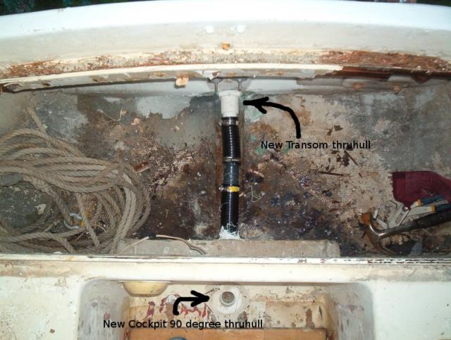

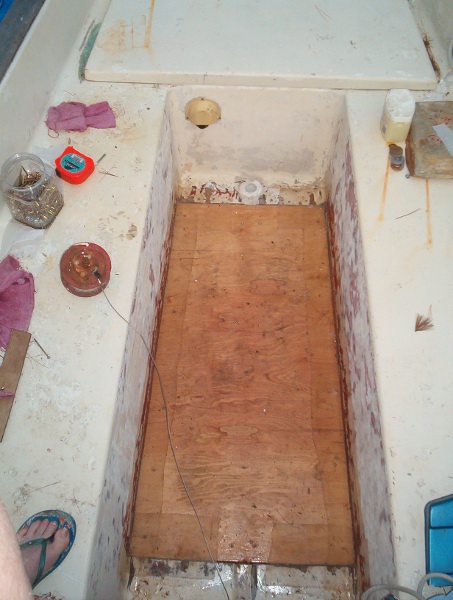

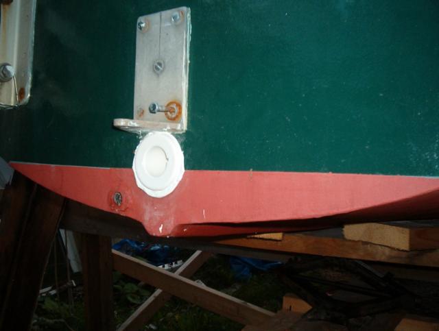

Oh yea I now have the new cockpit drain installed and the new patch in the cockpit sole installed with the first layer of glass and resin. Two more layers of glass tape and resin and she'll be ready to grind down to a feater edge then add the rounded fillets and it will be ready to paint. At least now its a thru hull in the cockpit sole and not a chance that it can become dislodged. Have to get a coupler for the hose as it was just a bit short to reach the thru hull in the transom but no big deal, I might even add a ballcock so we don't have to mess about with a stopper. At least now when it rains the water will no longer drain into the cabin bilge. I also discovered that there is enough room to add 2 lockers to the cockpit seats both port and starboard. The remaining space I'll fill with 2 part pour in foam to add positive flotation. Next project will be installing the water tank and maybe painting the inside cabin before closing her up for the winter.
