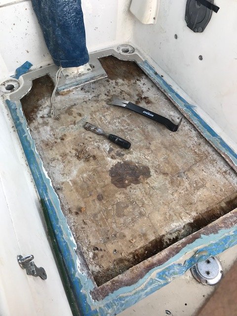

I'm in the middle of a project and looking for some guidance. I have a 1974 Pearson 30 that had some softness in the aft half of the cockpit sole. I took the plunge and cut out a section of the top skin to have a good look. I found wet balsa and some mush. I've since cut out more top skin and I'm trying to figure out how to repair it. As it stands now, I have a 2" ledge and I've removed all the balsa that I can.
So my questions are around how to lay the glass up. The boat had a 3/4" balsa core and the top skin laminate is 3/8" with a slight camber. I suspect that this was built up with a polyester resin. I have some 3/4" balsa that I've been trying to fit but its proven very difficult to wedge it under the remaining lip of the top skin. I don't have a good way to sand it down and the underside of the lip isn't so unform. I'm pretty frustrated with that- and then not sure the best way to build up the laminate. Using epoxy and 10 oz cloth, it would take a large number of layers. Fiberglass mat seems not conducive to epoxy and it will cost a small fortune to rebuild it that thickness with epoxy- I think.
So I am considering rebuilding the core with 1" balsa or corecell and thinking that I wouldn't need such a build up with epoxy and fabric. With that approach, I could have the same overall height as what is left of my cockpit. That would still leave me with the issue of fitting core under that lip but I could likely fill it with thickened epoxy.

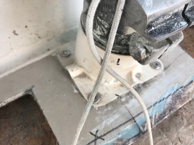

Forgot to ask a secondary question. I suspect that the water may be coming through where those four bolts are holding down that cap underneath my tiller. There doesn't seem to be any core material left under that cap and there is a big mass of epoxy that I suspect was laid by a previous owner. Are those four bolts just to hold down the cover or are they structural. I'll probably want to rebed them- but want to be sure my rudder doesn't fall to the bottom of the lake!

The latest idea is to take the 3/4" balsa pieces that I previously sanded down to about 06-0.70" and start filling in under the lip one block at a time using thickened epoxy and tapping them in as needed. It might take me some time but at least I'll have a process, provided I can figure out a way to do it neatly. How critical is it to entirely fill in under than lip? Maybe I am worrying too much about that.
Once I get under the lip filled in, then I can use the rest of the 3/4" balsa and glass in the original section/s that I cut out... or build it up new with 1708 (I think). I'm doing this in my slip, under the hot Texas sun so its a bit of a mental and physical challenge!
One way or the other, I need to get her back into sailing condition! This little project has become more daunting.

So having crawled back into the boat today, those four screws are nothing but a cover and source of leaks. The funny thing is that the cover doesn't move even when unscrewed and pried up. Its held in place by the rudder/tiller assembly.
I bought some balsa in both 1/2" and 1/4" to supplement my stock of 3/4". Half inch will go under that difficult lip. I will then fill the rest with 3/4", some of which has already been rough sanded to about 0.6-.07 to make a contour at the edges, but is still 3/4" in the middle. Then, the 1/4" balsa will be bonded to that 3/4" stock, making a 1" surface that I sand again for a contour. Finally, I intend to build up a 1/8" skin using two, possibly three layers of 1708 and West Systems epoxy. I'm not intending to use the old skin as I prefer to just start fresh.
That should get me the same top contour and provide a strong epoxy laminate.
Does that sound a reasonable approach?

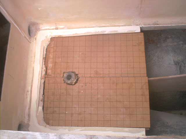

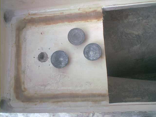

Use a product like Cooca Board or Divinycell H80 that is grid scored.
Save your money and use polyester or vinylester resin that will last as long as the rest of the boat.
below is a picture of my Cat 22 cockpit that was damaged by ice under the glass. I replaced the whole floor.
