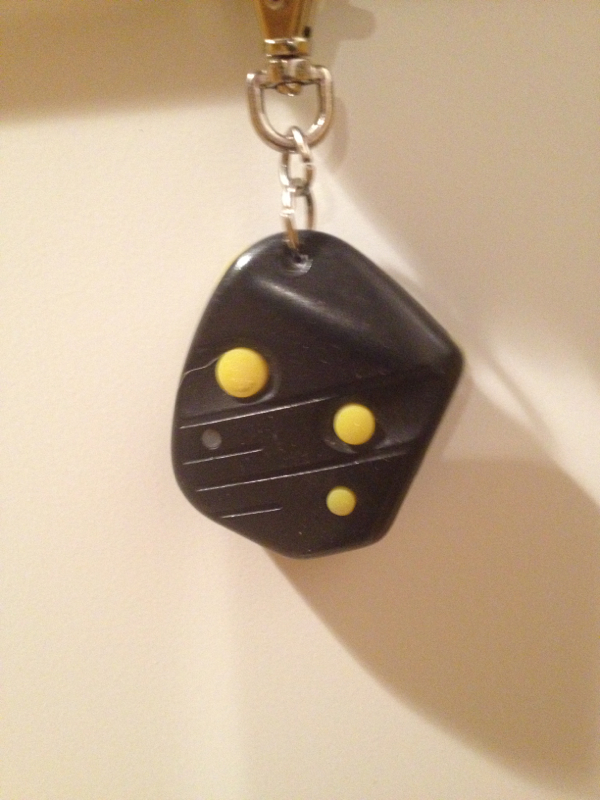

Nov 24, 2012
586
Just took a pic of mine - here's what it looks like. FYI if you or the PO don't have it you can buy a replacement. I've seen them in the WM catalog I believe it's aqua signal but don't quote on that.
Sep 19, 2011
53
Beneteau Oceanis 423 Rhode Island
Thanks so much for the pic Captn TJ. I had no idea the boat even had one. I will check with the previous owners.
