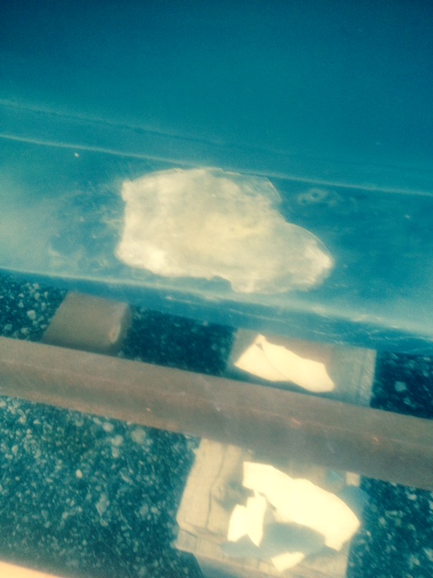

Wondering what the best solution for filling the void left from the coating flaking off the lead wing keel. Something like Interlux watertite epoxy filler or just gel coat? Any suggestions appreciated as I have a launch date in a week.

If it were my own wing keel I would probably clean and sand it. Would consider spraying it with epoxy paint and then cover with ablative paint. Havn't had to do it but someone probably has and will comment on this. Chief

I had the same problem with my keel. I took it all the way down to metal. Then I put POR15 on it. Then I filled with Marine Tec and sanded smooth applied two coats of barrier coat then bottom paint. It has been with out any problems for three years now.

Mine got dinged by the yard while blocking for the winter season a couple of years ago. Here is what I did:
--Sanded away the bottom paint about a 1/4" beyond the repair area to expose the gelcoat.
--Sanded the exposed gelcoat lightly with 80 grit. clean with Acetone or equivalant
--When I was ready to do the job sanded the exposed lead until shiny, wiped down with Acetone then quickly painted on a thin coat of unthickened epoxy (I used West).
--Let the resin kick but not cure, about 20 minutes, then applied some thickened epoxy to fair the area. Once fully cured, lightly sanded. Applied bottom paint as usual.
The key is get the exposed lead as clean as possible and not let any contamination get in the damaged area.
Very straightforward. Hope this helps....

Thanks for the quick responses! I think I'll try the West Systems epoxy route that Solstice recommends since I've got some left over from another project.
