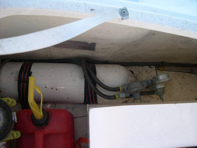

Mine has a vent on the CNG system. It is not a vent of the locker but of the CNG lines ( maybe a High pressure relief ). The thru hull is on the port side by the manual bilge pump discharge..In the picture, Out of the regulator, one line goes to the thru hull, the other to the stove.
