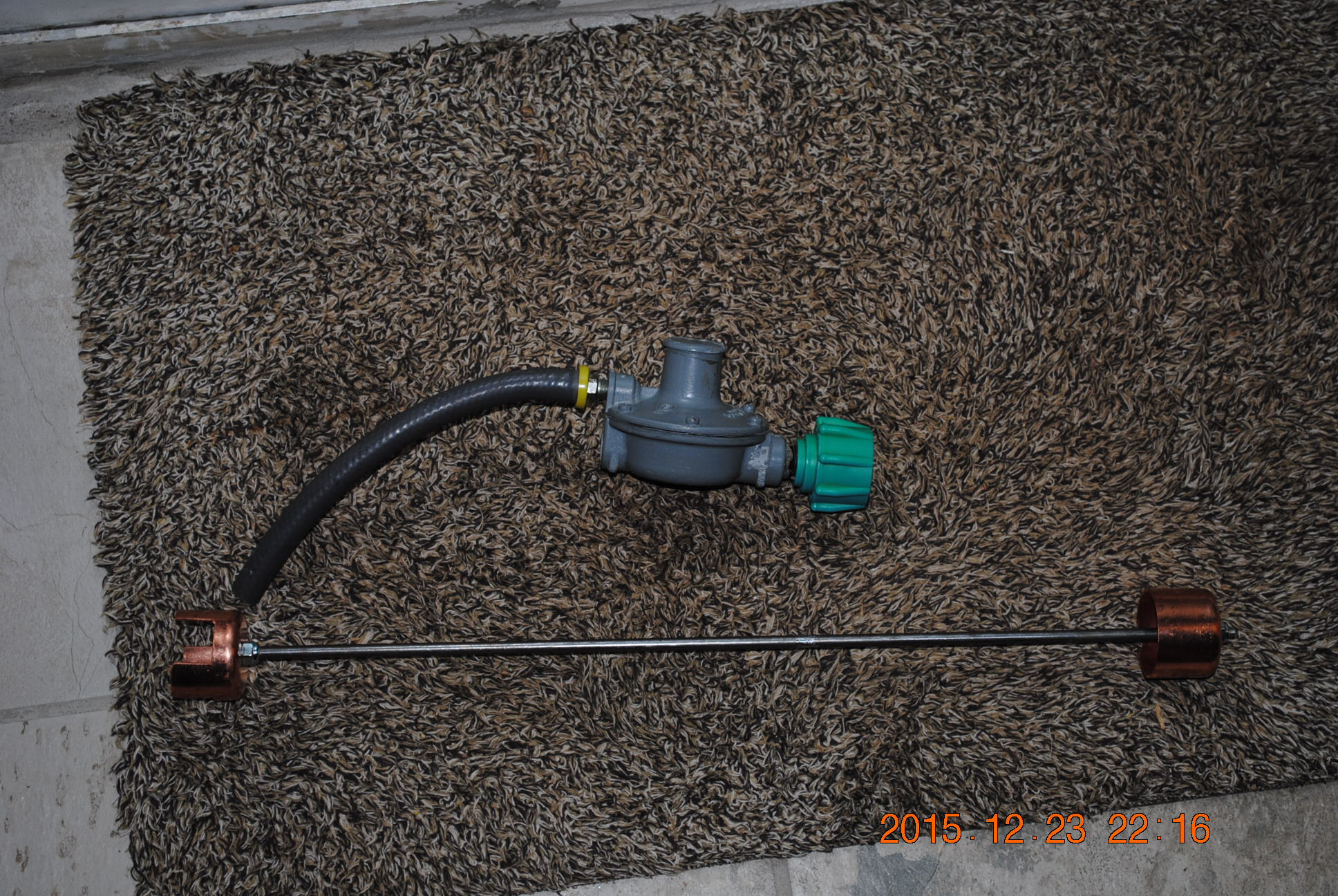

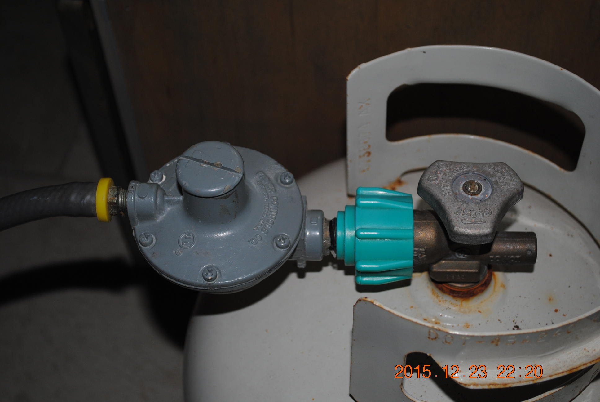

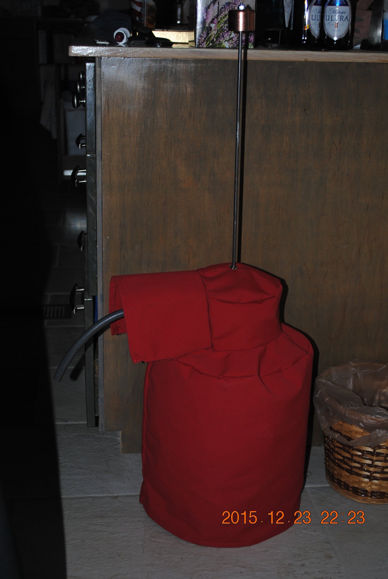

Jun 6, 2006
6,990
Did this a couple of years ago, reused the low pressure regulator from the CNG (the big gray one not the smaller one next to the CNG tank outlet) and a propane quick connect that screws into the regulator input. cost about $5. I did not change out the jets in the stove but did adjust the delivery pressure to account for the difference between propane and CNG. It is the largish flat blade screw head in the "tower" in the center of the regulator. Take off the cap and CAREFULLY adjust (screw in our out) the plastic screw while a helper watches the lit burner till there is the normal blue flame. If memory serves I only had to turn it a turn or two. Mounted the tank on the stern so did not need a container. We are pretty annal about propane so we can get away with not having a solenoid. Did make an extension handle so we did not have to reach down to manually turn off/on the tank.2015-12-23_22-16-42.jpg 2015-12-23_22-16-58.jpg 2015-12-23_22-20-42.jpg 2015-12-23_22-23-38.jpg
