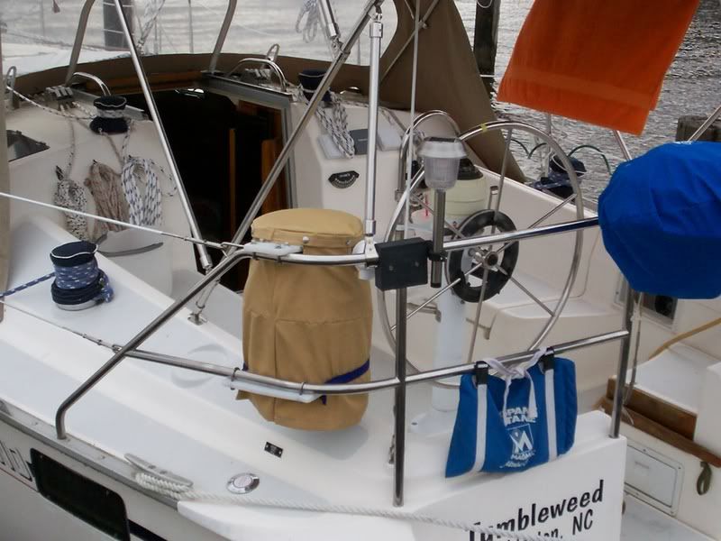

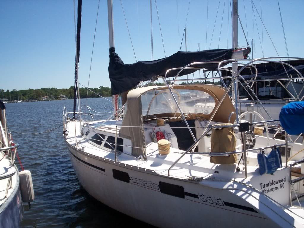

We have a Hunter 35.5 and didn't have enough room for a propane locker so we built a SS mount and hung a propane bottle from the stern rail. The propane bottle is of fiberglass construction so no chance of a bleve from catastophic failure also not rust. We purchased the new orfices for the stove from the manufacturer of our stove and ran a hose from the tankregulator to the stove using a clam style bulkhead fitting and we dressed up thwe whole shebang with a sunbrella cover. We valve in the gas when on the boat and valve out and bleed the system when off. I really see no need for an automatic shut off if you use it responsibly. CnG was expensive and hard to come by and we love to cook. this was a good improvement to our vessel.
http://i83.photobucket.com/albums/j320/SV_Tumbleweed/100_2072.jpg
http://i83.photobucket.com/albums/j320/SV_Tumbleweed/100_0592.jpg
http://i83.photobucket.com/albums/j320/SV_Tumbleweed/100_0593.jpg
