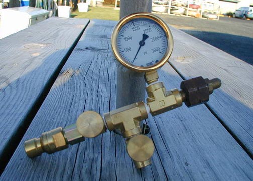

Just to let you know I have put together an adapter and use it regularly as we live aboard and my wife loves to cook. I fill a tank about every six weeks for the amazing cost of $0.70, yes 70 cents, at a local gas station. In MD we have about 5 locations to fuel CNG vehicles so I started looking for the fittings to make the adapter up. First and foremost is the safety issue; our boat tanks are rated at 2400psi service pressure, the fill pressure at the station is set at 3000psi for the vehicle tanks. Our bottles also have a safety vent on the valve that I hope works if required. The adapter consists of the bottle fitting, a tee with the pressure gage, a needle valve to regulate flow, a second tee with a valve to vent off, and the all-important fill fitting for the pump connector. All fittings are rated at 4000psi or more. Total cost about $100. I am currently sourcing new 3000psi bottles approximate cost $175, not bad considering the possibility of death during a refill and they will hold more too. As far as the attendant, our stations are self serve and the only strange looks I get are because I can only get 70 cents in and it's full. Believe me I always shut it off at 2400 psi. I'll put together a list of parts and sources if you are interested. I love CNG, as alcohol was such a bummer on the old boat.

CNG Fill Adapter Parts List
CNG Fill Adapter Mcmaster Carr Parts List 79215A666CGA 350 Nut1ea 2.40 79215A667CGA 350 Nipple1ea 2.69 4090K53000psi brass-case Gage1ea31.18 3845K13000psi ABS-case Gage14.86 7833K141/4" needle valve Brass MxM1ea16.53 7833K211/4" needle valve Brass MxF1ea16.53 9171K271/4" Brass Tee 3000psi1ea 6.22 9171K321/4" Brass Tee 3000psi MxFxF 1ea 9.68 Snap-Tite Inc BVGVN2-P30 NGV-2 Brass Fill Connector 1/4" NPT connection 1ea~$30.00  Can be ordered from a local hydraulic/pneumatic dealer who handles Snap-Tite products. I would consider ordering it for you if you can’t get a local supplier. Start with this part, as the rest is standard off the shelf at: www.mcmaster.com
