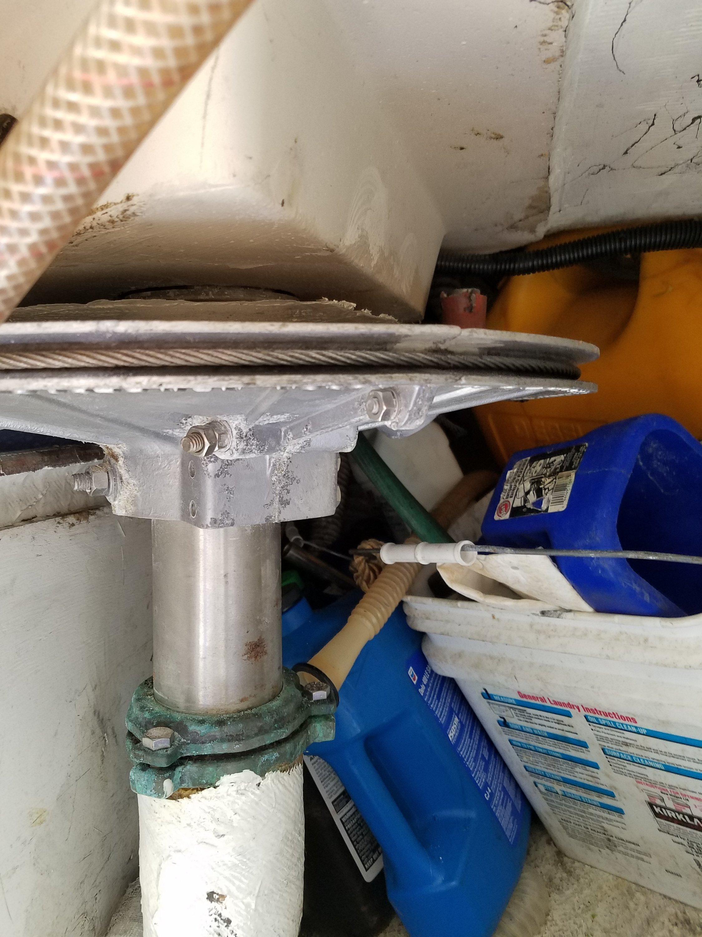

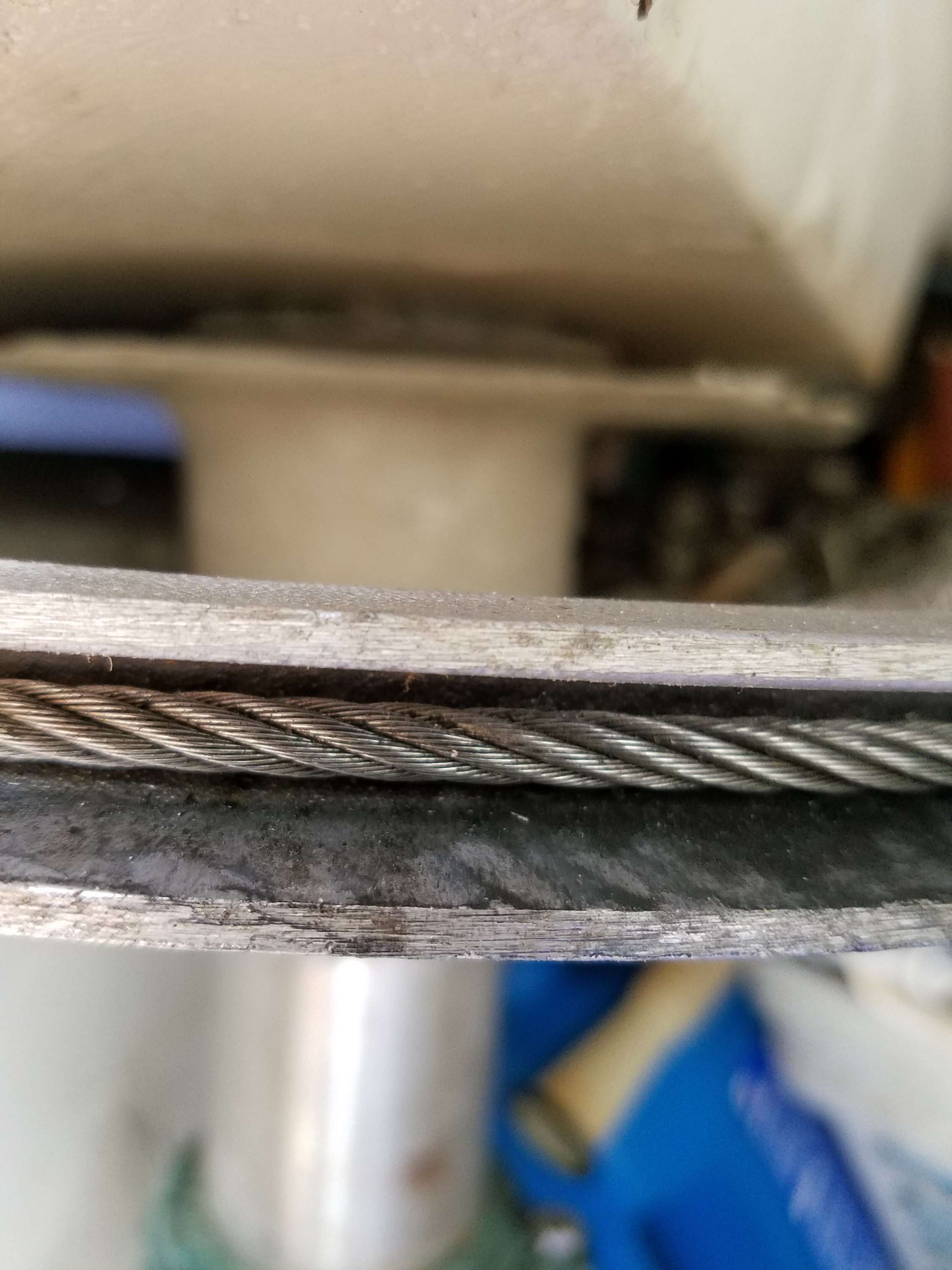

Today I went up in the aft cabin and looked back up under there. I found that the cable was quite loose. I am unable to tighten it because the nuts seem frozen, so I sprayed some PB blaster and will return in a day or two. Of greater concern is what I saw around the post. Take a look at the pictures. It looks to me like either the rudder post has dropped down or that a section of fiber glass encasing the post has pulled away and come down on the post.

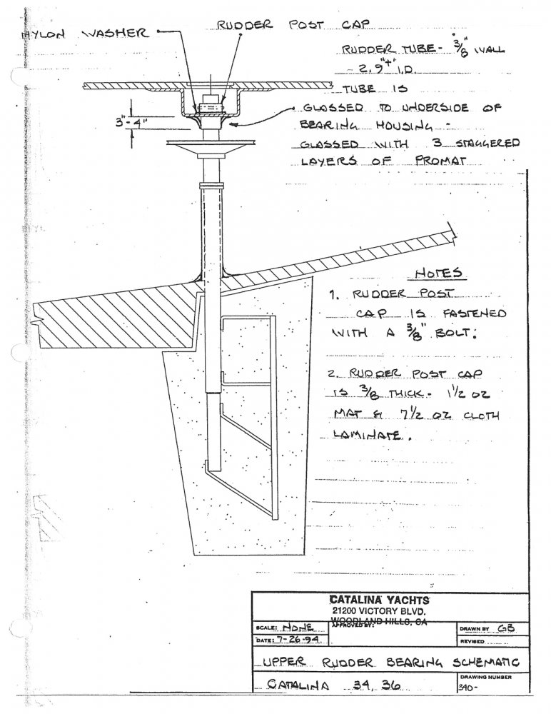

Can you get a shop drawing from Catalina that shows how the rudder post was designed? That will give you clues about how it should be.

What is weird is this: Although you can barely see it from the photos, it looks as if the quadrant is high based on how the cable runs. In other words, as the cable runs forward on the quadrant, it actually rubs against the bottom of the groove in the quadrant.

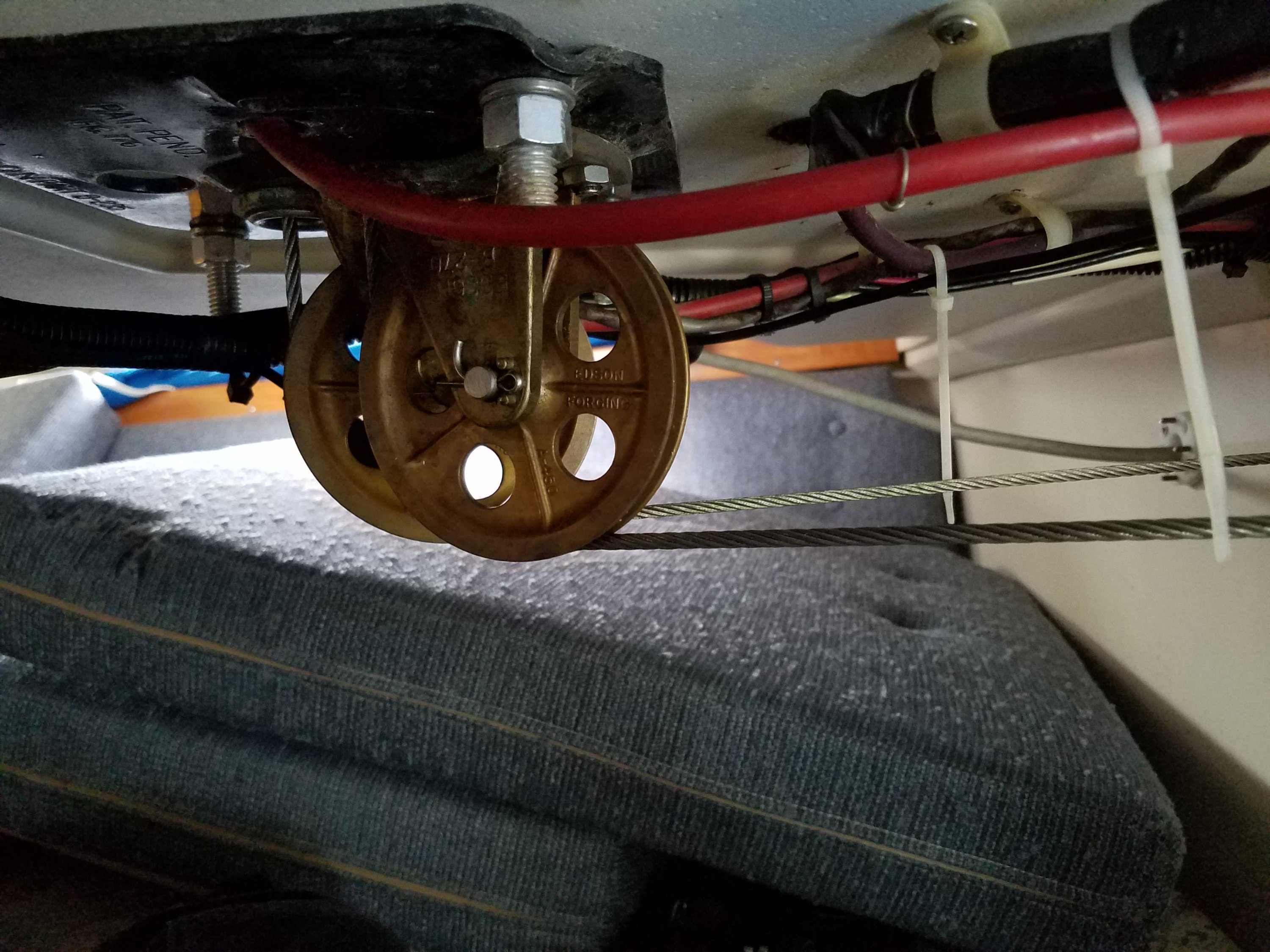

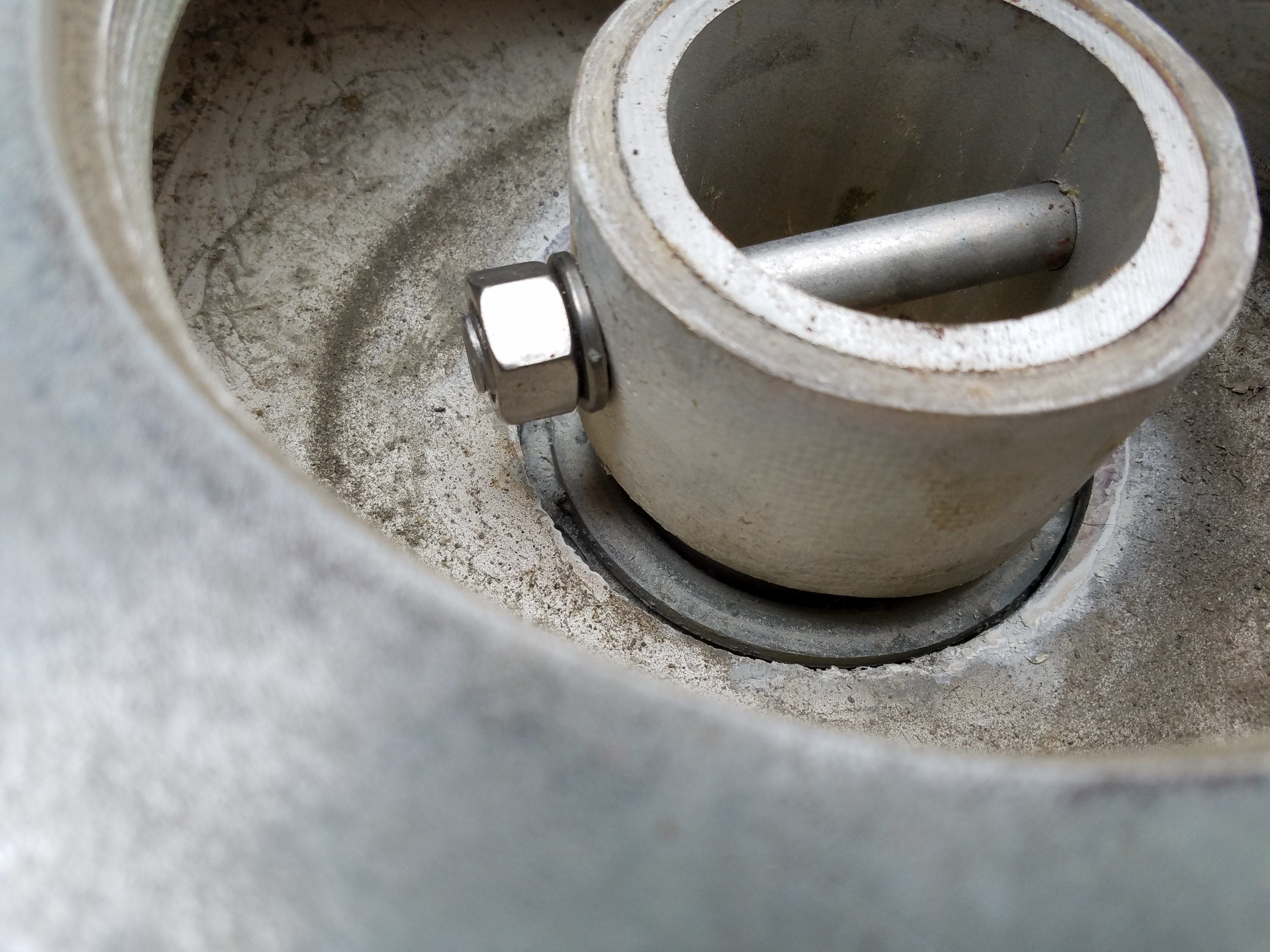

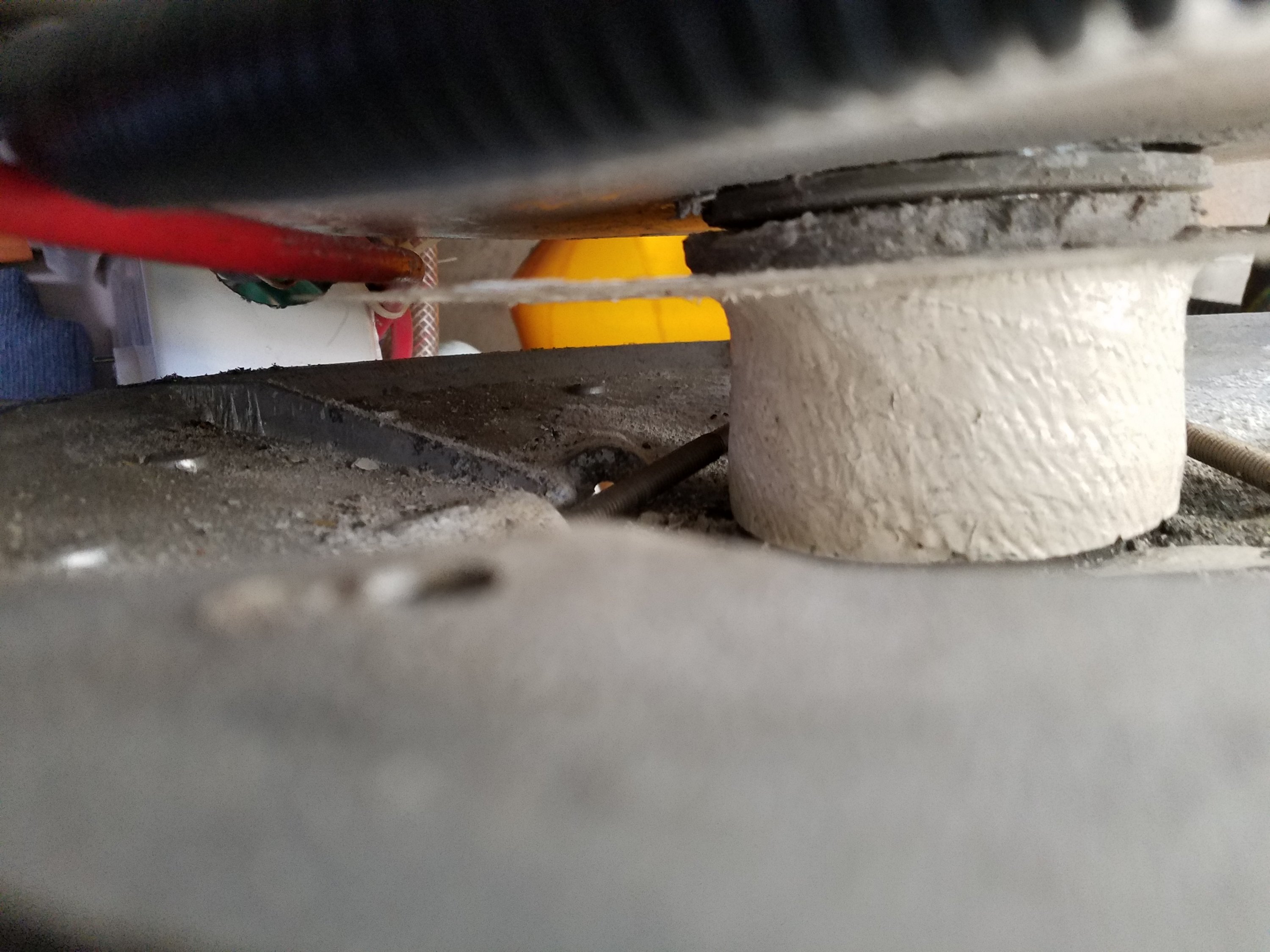

Here are some additional pictures. The first one is of the pulleys that lead the cable to the quadrant. I suspect that the noise I was hearing was from the cable being way too loose, which gave too much side-to-side play in the wheel of the pulley. I also suspect that the noise is a different issue from what else I saw. The second picture is taken from the deck with the deck plate removed. The third is a close-up of what I'm seeing from below. I was able to slide that part that's come loose up towards the bottom of the deck, but not all the way up. I think I might have to break down and have a yard take a look at this. It may be beyond my job description and loosing a rudder is a "little" more than I want to risk.

From the pictures it appears that your rudder is supported by the upper bearing. The collar on the outside of the rudder tube rests on the upper bearing. The support for the upper bearing has failed and that is allowing the bearing to slide downward leading to the up and down play in the rudder. Pull the boat, drop the rudder, take precise measurements, raise the upper bearing and rebuild its support, get some spacers for between the top of the rudder and hull and between the support collar and upper bearing and reassemble. All within the talents of a DIYer.

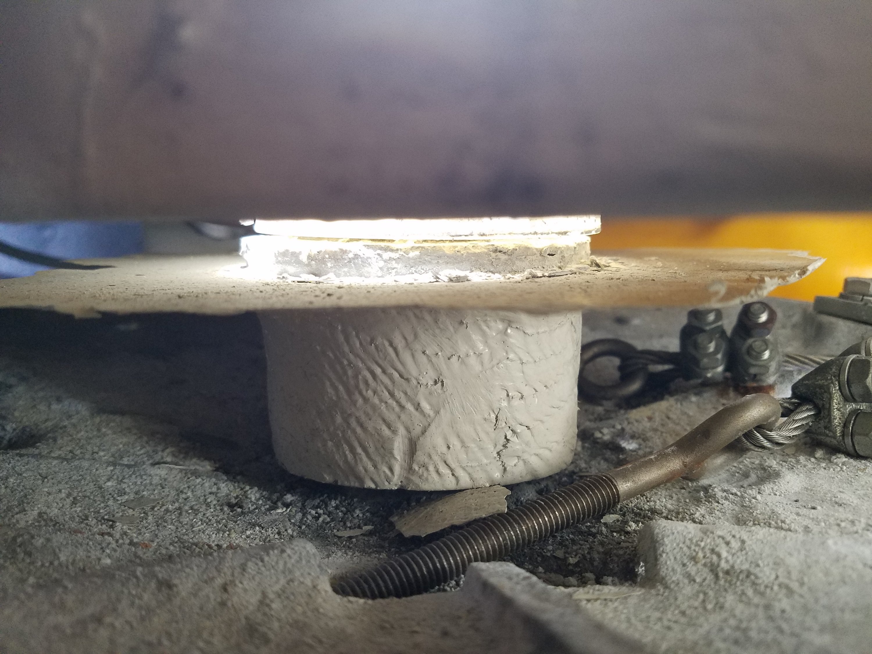

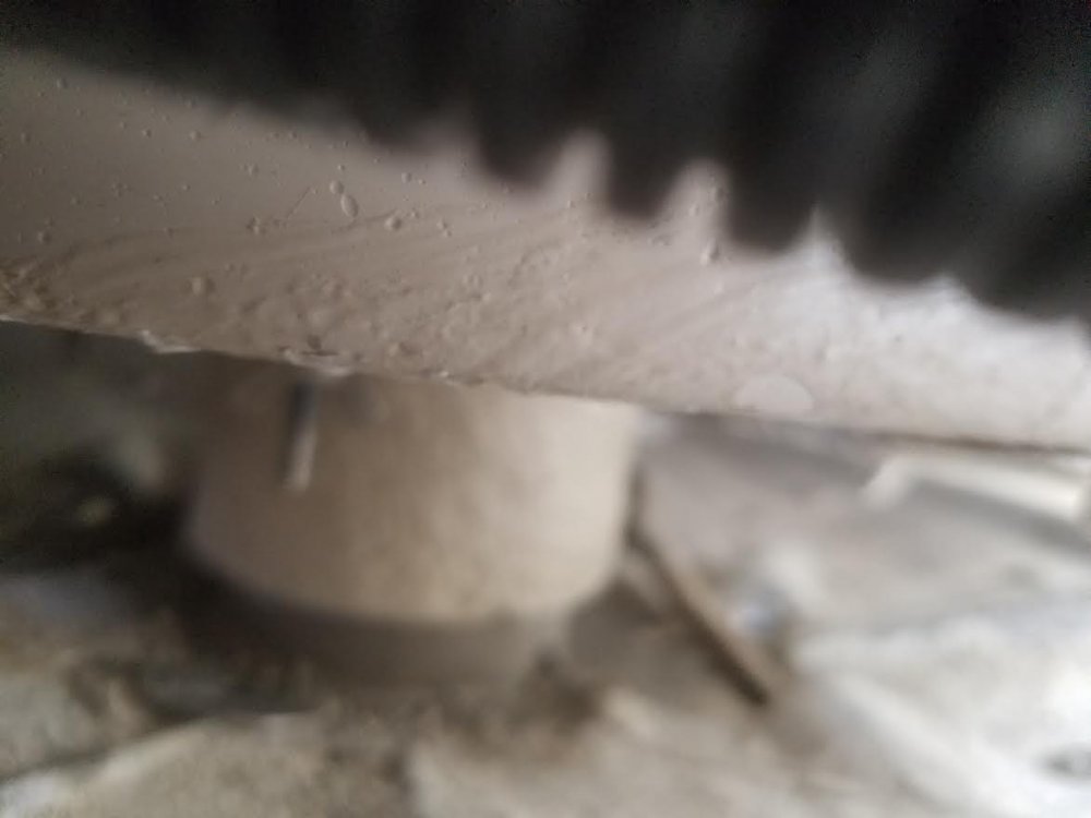

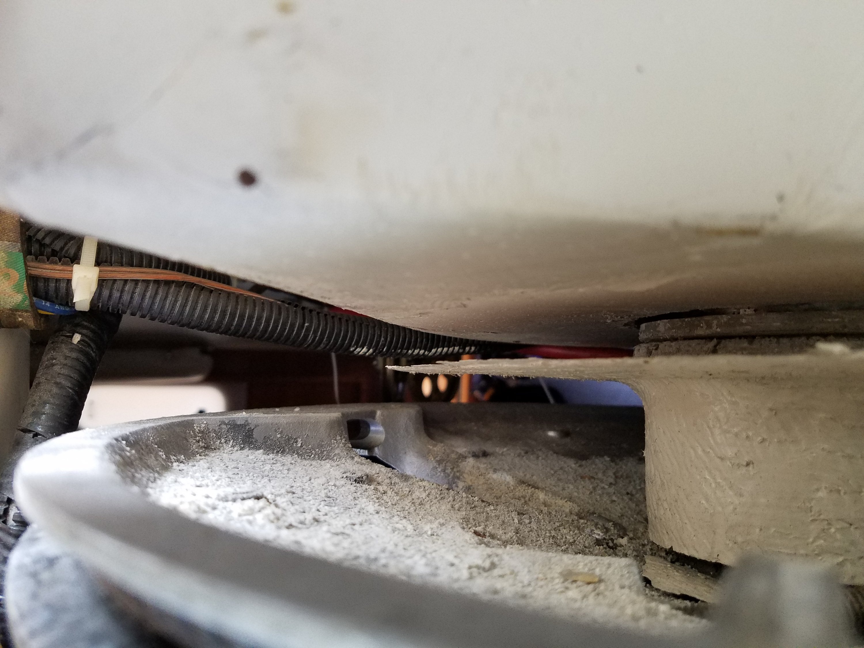

So, here's the latest on this issue:
I contacted Catalina. The guy I spoke with (Warren) seemed to think that the collar itself had come away and that all I needed to do was to raise it back up to the underside of the deck there and fix it in place. I did that with 5200 plus some screws. (See photo #1.) Before, it was only fixed in place with a single layer of fiver glass, so I think it's at least as strong. One thing that concerns me a little is the fact that the sketch that they sent me shows the collar down below the top of the post. (See photo #3.) On mine, it is exactly flush. (See photo #2) I was worried that this meant that the post had, in fact, dropped down. (Warren assured me that this was impossible unless I'd hit something with the rudder, which I haven't done to my knowledge.) I suspect that it's just an anomaly in the drawing, for this reason: Given how that bolt fits through the collar and the post, if the post were raised it would mean that the collar would have to be above the nylon bushing rather than resting on it, which is exactly what it's doing right now.
I took the boat out the other day and among other things the knocking noise wasn't there. I don't know what caused it - maybe that the cable was very loose and was causing the pulley to shift from side to side on a port tack.
Thanks again to everybody for their comments and any further ideas are appreciated.
