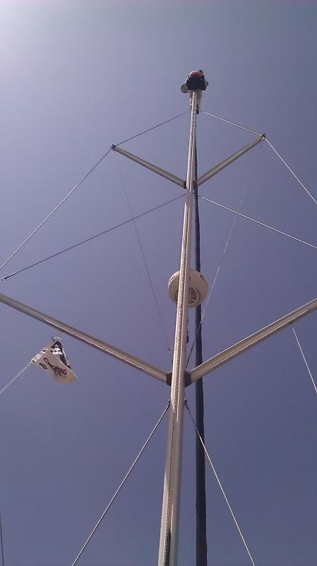

I have an ATN top climber as well. Been up three times in the last week to replace a bulb and install a new VHF antenna. I use the main halyard to raise a line and then use the spin halyard as a back-up safety line. I feel fairly comfortable going up/down but it does require some effort.

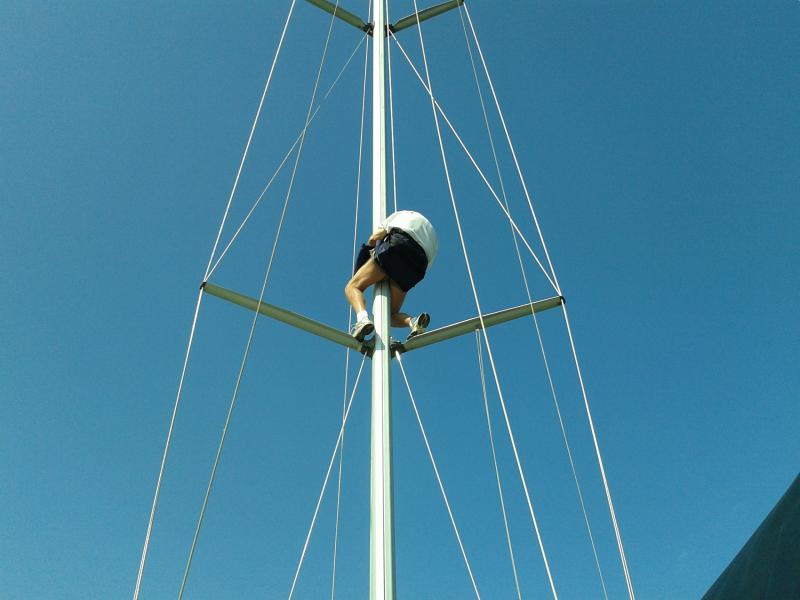

My wife has been up in the Bosun's Chair a fair number of times. She seems to actually enjoy it!
