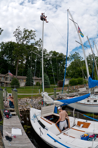

I attempted to have myself hoisted on my 25.5 in a bosuns chair. I'm 225 lbs after lunch. After 3 fett off the deck, we decided to bring me down. I then used my folding little giant ladder as I was only repairing the steaming light. We safety strapped the main halyyard under my arms and up the ladder I went. It worked really well. The ladder was on top of life cushions to protect the deck surface.
See attached link.
http://i226.photobucket.com/albums/dd6/twodzusfittings/IMGP4209.jpg
