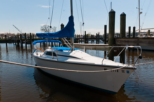

I have this issue as well at my slip. I hate using the anchor locker cleat. That's what the PO did and I used it that way last season. I have a metal 2" ring attached to that metal post in front of the anchor locker. I guide the two dock lines through the ring and into the locker. It's highly annoying. I debated getting a couple of those cleats that fold down when not in use and mounting behind the anchor locker... but haven't decided how to fix this issue yet. If anybody has any suggestions for bow cleats, I'd love to see pictures!
Back in the slip for 2011! by Paladin27, on Flickr
