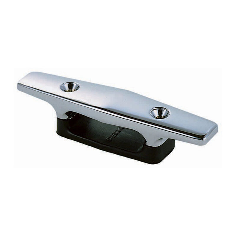

I just purchased a 1996 Hunter 26 and I will be mooring quite a bit. I thought I would add two bow cleats as their is only 1 center cleat on the bow right now. I have a 5/8" bridle from my previous 27 Catalina that I plan on using.
Do you any of you recommend a cleat brand/type?
I found this one.... link what do yall think? I like the fact that it facilitates a 5/8" line but don't like the plastic portion, unless I'm being to over critical?

I know the boat well. In the V berth you will need to remove a triangular board located forward to access the anchor locker area. You can put cleats in the area of the deck there on both sides but strongly recommend backing plates.
As for the bridle, make sure it is covered so it will not damage the boat nor chafe itself. You will see the back of the bow eye. You can reinforce the bow eye with a round pipe.

Thanks for your suggestion on the pipe. If I add the pipe , would it be ok to connect to that if I want some redundancy while putting the boat unoccupied on a mooring.?
