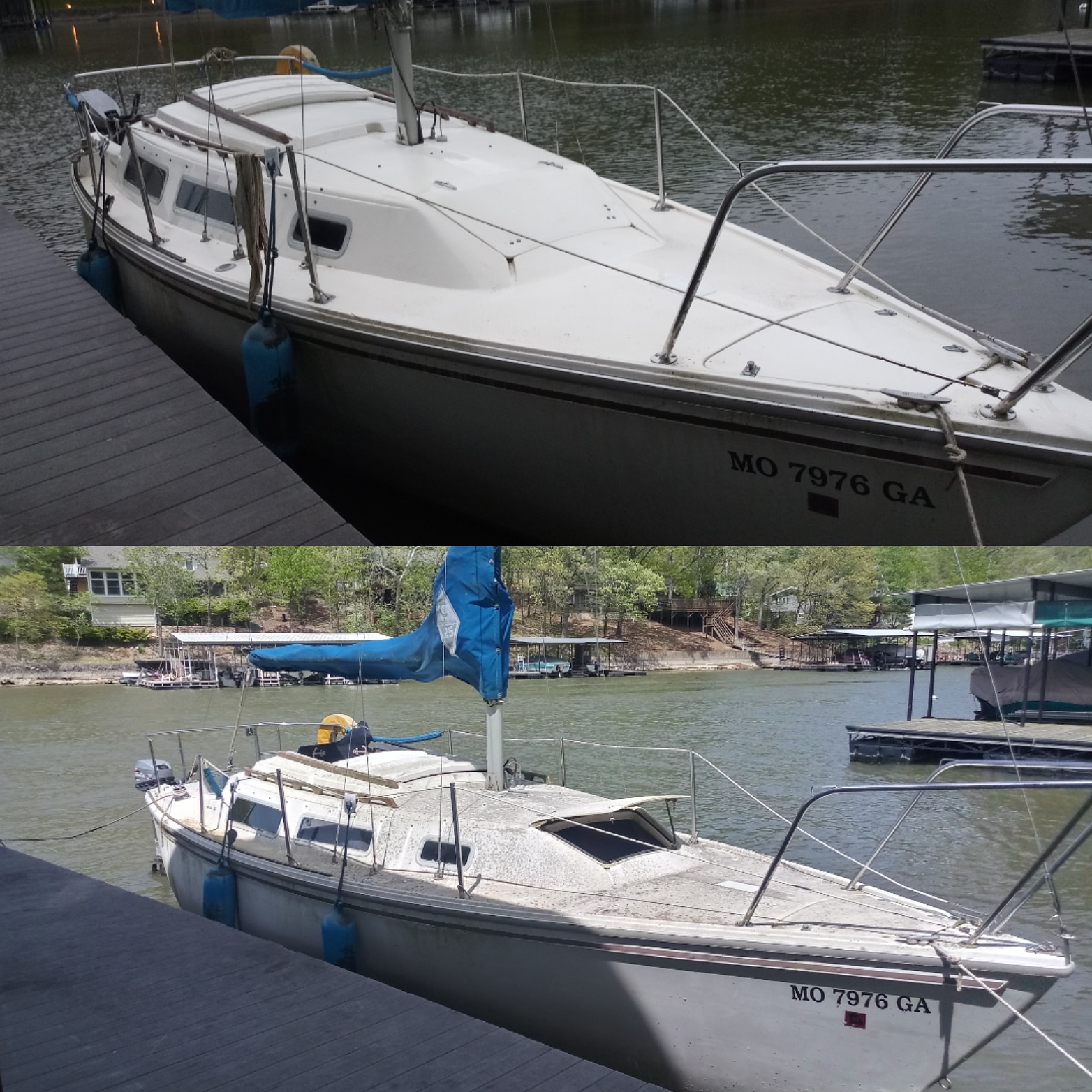

I just got my butt chewed on a FB page for using this to clean mold from my decks. What are your all's thoughts? You'd have thought I was dumping used motor oil by their reactions. We used this for years in vinyl siding and wooden decks. I always thought of it as mild and somewhat environmentally friendly.
I saw that yesterday & said oh boy, here we go... I wouldn't worry about using TSP long as your boat isn't in the water. Far as FB or any forum, there are those that will always flip out over something if you're not in line with their thinking.

It does a stellar job of loosening up the mold. I mixed it pretty weak, maybe 3/4 cup to 3 gallons of water. I wet out sections, let it set a couple minutes and gave it a quick scrub with a stiff brush. I still need to get the nooks and crannies. The whole thing needs and actual wash now.
Not bad though for a boat that hadn't moved in years..
