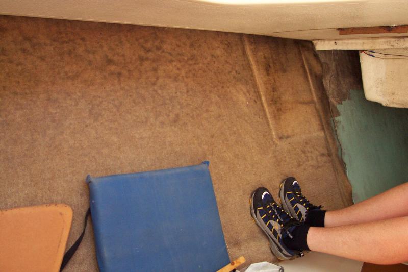

Now that the Summer in New Orleans has finally broken, I've put my 20 year old 23.5 back in the water. While cleaning out the detritus which collects inside a boat stored in a working boat yard, I took a long look at the fuzzy cloth covering on the hull interior in the forward berthing space. I guess the color was a kind of mottled dull gray with brownish spots. Had any prior owner ever tried to clean that covering? Didn't look like it.
So I took my spray bottle of Clorox Cleanser, which specifically warns against use on fabrics, sprayed the fuzzy cloth and lightly scrubbed with a frequently rinsed, damp sponge. Big difference. The brown has disappeared and the fuzz is now a bright light grey. And the fuzzy fabric appears undamaged in spite of the Clorox warning. The effort took 20 minutes...time well spent.

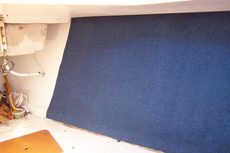

Or new carpet
About 11 years ago we scraped off the old and put in a new blue outdoor carpet that we basically glued on, but applied only in patches so that if we had to get it off sometime it would not be too difficult.
This was an easy, inexpensive job and the results are very pleasing.
