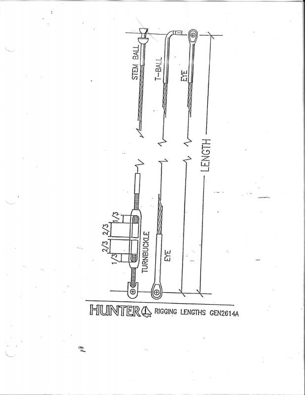

Standing Rigging
Headstay 5/23" 1x19 28' 1 1/4"
Backstay 5/32" 1x19 29' 11"
Upper Shrouds 5/32 1x19 26" 9 1/4"
Lower Shrouds 5/32 1x19 14'

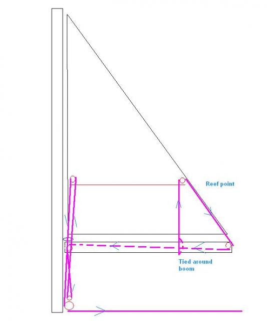

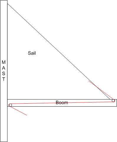

2x Jiffy Reef 1/4" 18'

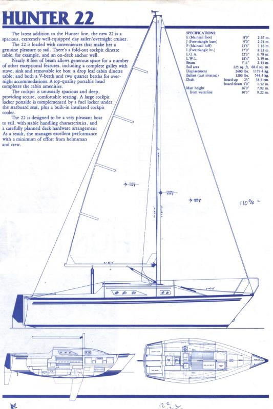

Length over all (LOA): 22 ‘ 3″
Length at water line (LWL): 18′ 4″
Beam: 7″ 11″
Draft: Swing keel version: board up: 23″, board down: 5′
Draft: Fixed keel version: 3′ 2″
Displacement: Swing keel version: 3,200 pounds
Displacement: Fixed keel version: 3,400 pounds
Ballast: Swing keel version: Lead: 1,300 pounds inside the hull
Ballast: Fixed keel version: Lead: 1,400 pounds inside hull and fixed keel
Mast height: 26′ from cabin top and 30′ 3″ from water line
Sail area: 220 square feet
E (Mainsail foot): 8′ 4″
J (Foretriangle base): 9′ 0″
P (Mainsail luff): 23′ 6″
I (Foretriangle height): 27′ 0″
Years produced: 1980-1985

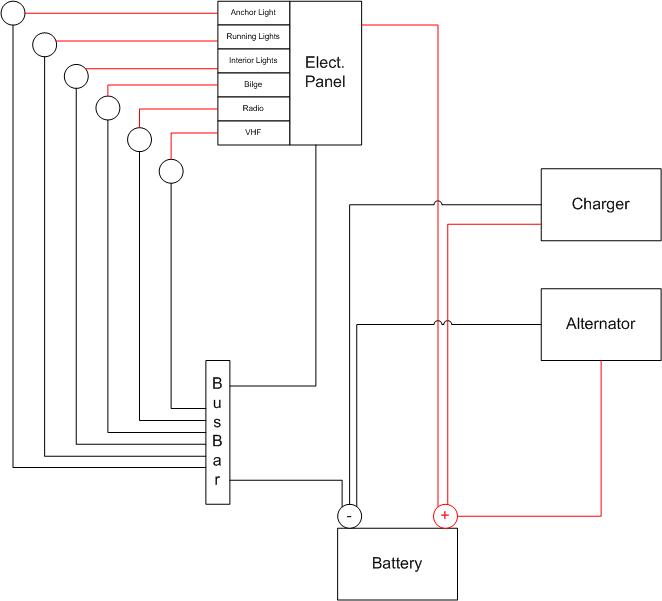

Electrical
This is not the OEM electrical map, this is what I did when I replaced the wiring harness. I added a bus bar, and a connection to the alternator on the o/b

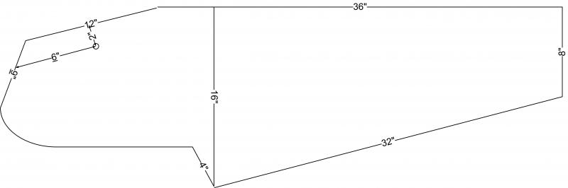

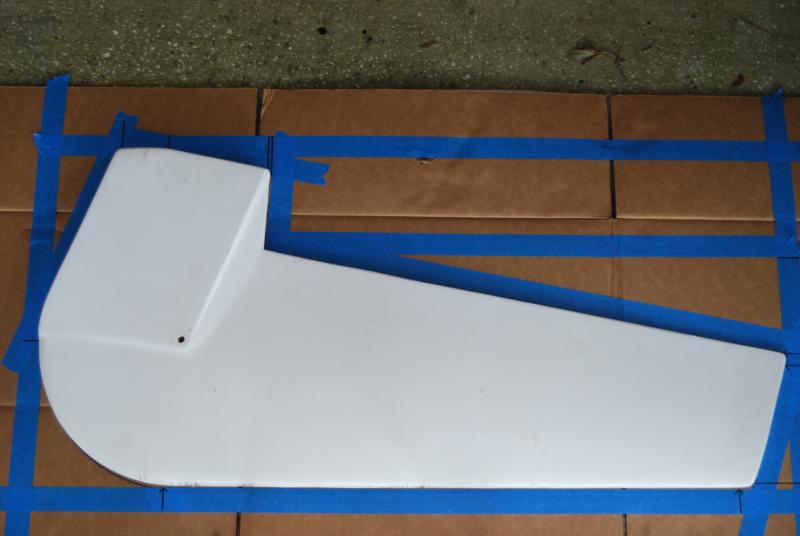

OEM Keel
New keel from Foss. Not sure if i have the dimensions written down, but at least this is what a brand new keel looks like. There is one alteration this has from the OEM keel. I sent Foss a bronze bushing to install as they made it. The bronze bushing and s.s. pin were manufactured locally.

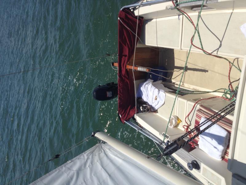

Not quite tiller to sheet steering...
I lashed the the tiller to a couple lines attached to the toe rail. I attached the lines to the tiller with two of the smallest harken cam cleats. Depending on the sea state in the Gulf I could sail like this for hours. This worked great for me when close hauled to just about beam reaching. After that no worky, and I would then have to use some sort of tiller to sheet steering.
Also notice a cool (i think so) tip, my jib sheets are color coded red and green for port and starboard sides. I also used cross sheeting, so you will see in this pic that my starboard sheet is the working sheet, but is cleated off on the port side.
