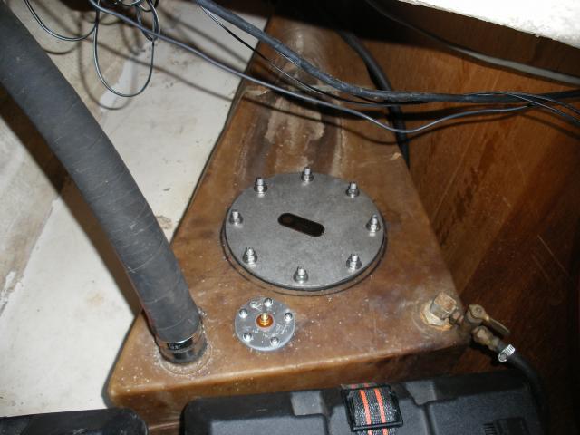

Take a good look at the SeaBilt product before you proceed with the Lexan solution. If you set it up in the same manner, you might have success in keeping the fuel in the tank and not leaking out. They are made for commercial installations.
Here's a picture of mine installed in my H34's tank top. Others on these forums have turned to them after less success with alternative solutions (I don't work for them and they're a privately held company).

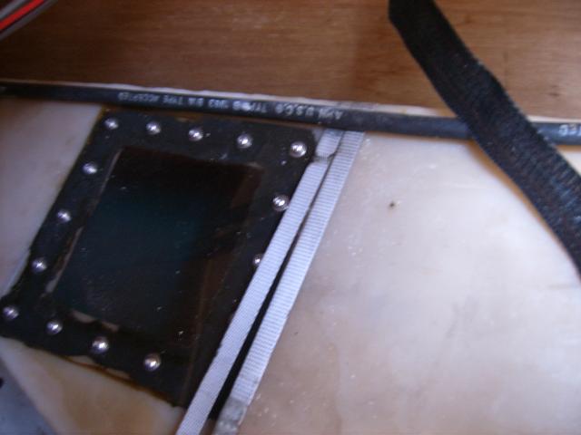

This is a job I did about 4 years ago. I did it while on the hard - makes life easier. I siphoned the fuel out of the tank into a clean new large garbage can ( I had a full tank). I used a piece of garden hose- other wise you could be at it for a long time. I then cut a hole in the Poly tank- easy to do with a utility knife. You will be amazed at how much gunk is in there ( only siphon down to the last gallon or two) I took a gallon and a half of muck that looked more like it came out of an eaves trough than a diesel tank. Wipe the tank down thoroughly with lots of paper towel or clean rags.
I sealed the hole with a piece of 1/8 lexan sealed with Peramtex - used the blue tube that says impervious to kerosene.The thinness helps the cover conform to the curvature of the tank- they all seem to develop a concaveness. I screwed it down with self tapping screws- drilled and ran the screws in first then wiped the inside again to get the shavings out.
Here is a picture

Nice job. Have you ever had a problem with a leak or smell permeating from it? Since you did it have you had to remove it? Seems like it would be tough to clean the Permatex. I like the size of the opening. I have an aluminum tank. I'd use a hole saw and fabricate something similar to the SeaBilt version but using a Lexan cover for visual access. My boat sat for 4 years on the hard before I bought her. I have no idea if she had a full tank or not. I haven't had a problem yet but do see a few black granular specs in the bottom of my Racor filter.

The SeaBilt product is top notch and you're installation looks real clean. What holds the bolts from falling into the tank when you remove the nuts? I do like the idea of being able to see into the tank without having to remove the cover.

No problems with leaks or smell. I talked to a surveyor first and the ABYC spec for pressurizing the tank is only something like 3-4psi. I have not removed the cover since I put it on, I do anticipate having to carefully remove the Permatex, probably with something like a razor blade paint scraper. The hole is 7"X7", cover 1 inch bigger
BTW- this is a diesel tank- I have never considered there to be a big danger from explosions due to sparks. Anyone ever see or know first hand of an explosion with diesel in like circumstances?

the SeaBilt port's bolts are mounted on two half rings so you can insert them through the access hole into the tank then feed the bolt threads through the provided ring gasket then up through the holes you've drilled using the lid as a guide.
I drilled the first hole, put a bolt through the lid and into the hole, then drilled the second hole on the opposite side and did the same thing. Then, using the lid as a template so as not to misalign the holes for the bolts to come up through cleanly, I drilled the remaining holes.
If your tank has the concaveness in the top as Richard pointed out, you will need something stout in thickness to clamp up solid to the tank top to have the concaveness taken out so you don't get any leaks.
Your other post mentions plexi or Lexan but MaineSail points out the issue if there's a fire aboard in that area. I'd go with an aluminum set-up for the strength if you DIY. You can't see into the tank without a strong light source anyway.
