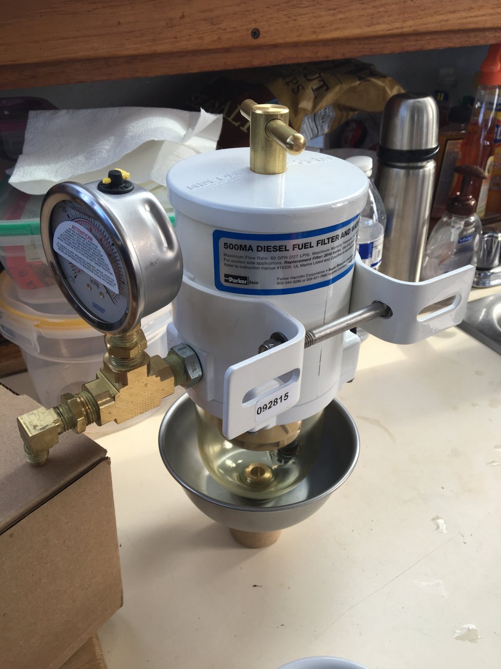

I installed a suction gauge on the outlet of my Racor filter. Very helpful in monitoring the condition of the filter.
Yes, yes and yes. I did the same.. No more guessing! I cleaned the tank, cleaned the pickup tube thoroughly, removed the strainer from the pickup tube and added the vacuum gauge. Happy motor now.
22,913
This is what my filter with attached gauge looked like before I installed it in my boat.
