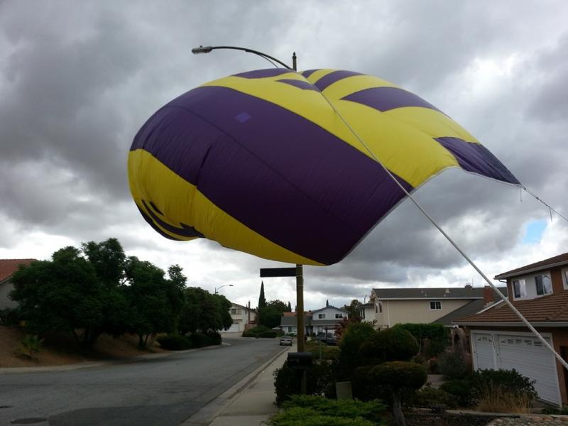

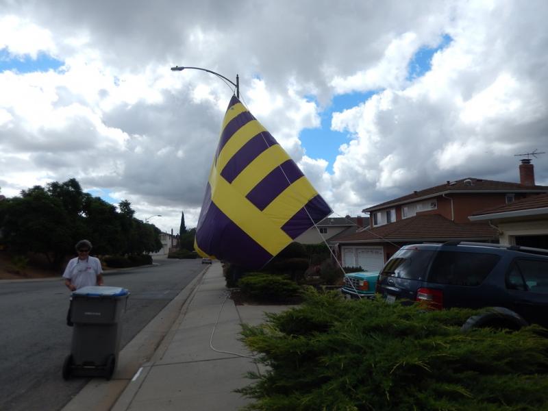

We didn't have visible mold but the sail, sock and bag smelled bad from a long time ago when the entire boat stank. This past spring I filled my recycle bin with water and I used some Woolite and Fabreze powders. It soaked for two days, stirring occasionally, then alternately siphoning the water out (that can weighed more than 300 lbs). I rinsed with fresh water several times. Luckily I live on a T intersection, so I have a very convenient mast next to the driveway for drying. I almost got it down before the police came. Luckily it was a neighbor who is my friend. He thought it was cool.
The colors did not run and it looks and smells nice.
